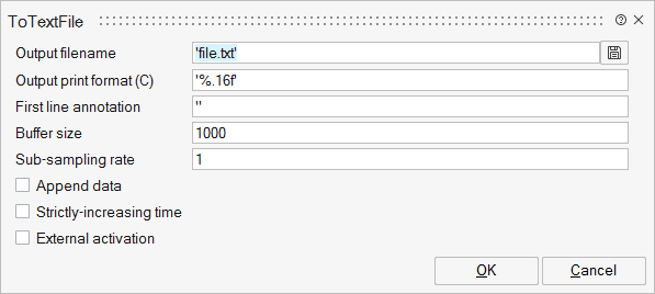

The ToTextFile block is used to save Activate data to a text file.
fname | Output filename | Name of the output text (Ascii) file. | String | |
cformat | Output print format (C) | A string describing the output printing format on the text file on each line. The format string should be compatible with the C language specifications. | String | |
FirstLine | First line annotation | A string that is printed at the first line of the text file. This field may be left empty (""). | String | |
BufferSize | Buffer size | In order to speed up the operation a buffer may be used. Once the buffr becomes full, it is flushed on the disk. | Scalar | |
SubS | Sub-sampling rate | The data is sub-sampled before being stored in the file. The default value is one, which produces no subsampling. Larger values reduce the size of the file. | Scalar | |
append | Append data | Number | 0 | |
increasingTime | Strictly-increasing time | Select to create a strictly-increasing time sequence. | Number | 0 |
Port 2 | activation | input | externalActivation |
discrete-time state | yes |
