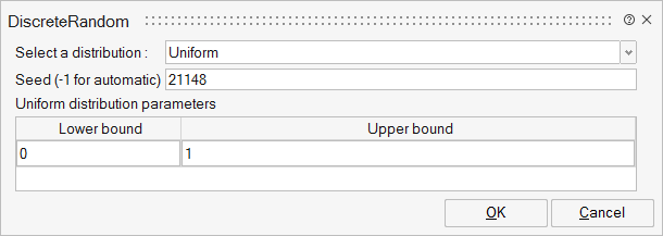

Supported distributions are: Bernoulli, Binomial, Poisson, Uniform, Geometric, HyperGeometric, Logarithminc, Negative Binomial.
distrib | Select a distribution : | Structure | ||
distrib/bernoulli | Bernoulli | Number | 0 | |
distrib/binomial | Binomial | Number | 0 | |
distrib/poisson | Poisson | Number | 0 | |
distrib/uniform | Uniform | Number | 0 | |
distrib/geometric | Geometric | Number | 0 | |
distrib/hgeometric | Hypergeometric | Number | 0 | |
distrib/log | Logarithmic | Number | 0 | |
distrib/neg_binomial | Negative binomial | Number | 0 | |
seed | Seed (-1 for automatic) | Seed for the random generator (scalar). seed must be an integer between 0 and 2^32-1. Negative value for seed means automatic selection. | Matrix | |

Unif | Uniform distribution parameters | Structure | ||
Unif/A | Lower bound | Cell of matrices | ||
Unif/B | Upper bound | Cell of matrices | ||
