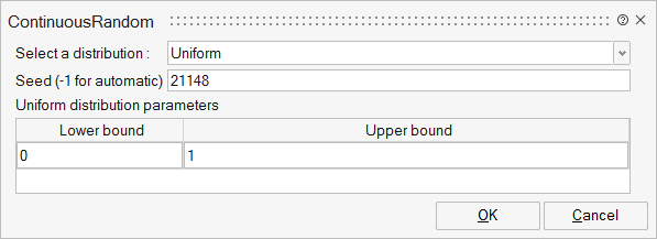

This block is a continuous random wave generator. Each output component takes piecewise constant random values. Each time an event is received on the block input activation port, the outputs take new independent random values. The output port size is given by the size of the parameter matrices. You can select the distribution.

seed | Seed (-1 for automatic) | Seed for the random generator (scalar). seed must be an integer between 0 and 2^32-1. Negative value for seed means automatic selection. | Matrix | |
Uniform_param | Uniform distribution parameters | Structure | ||
Uniform_param/A | Lower bound | Cell of matrices | ||
Uniform_param/B | Upper bound | Cell of matrices | ||
