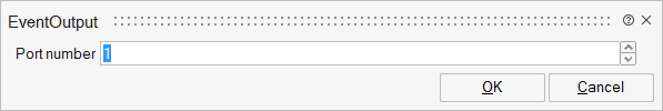

Placed in the diagram of a super block, the EventOutput block adds an activation output port to the super block for linking activation signals inside of the super block to blocks outside of the super block. Any link connected to the activation output port on the super block extends from the corresponding EventOutput block inside of the super block.
The parameter "Port number" determines the relationship between the port block and the port on the super block. By default, the output ports are numbered sequentially from left to right.
