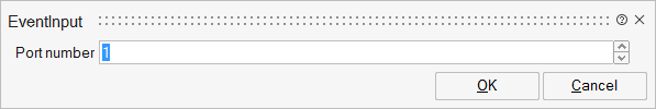

Placed in the diagram of a super block, the EventInput block adds an activation input port to the super block for linking activation signals outside of the super block to blocks inside of the super block. Any link, outside of the super block, that is connected to the activation input port extends to the corresponding EventInput block inside of the super block.
The parameter "Port number" determines the relationship between the port block and the port on the super block. By default, the input ports are numbered sequentially from left to right.
EventInput_0
portNumber
Port number
