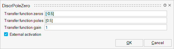

The DiscrPoleZero block implements, when activated at a fixed rate, a SISO linear system where its transfer function is defined by its poles and zeros.
zer | Transfer function zeros | Defines the zeros of the transfer function. The entries of the vector are the zeros of the numerator polynomial of the transfer function. | Vector | |
pol | Transfer function poles | Defines the poles of the transfer function. The entries of the vector are the poles of the denominator polynomial of the transfer function. The input and output may be of arbitrary but equal size, in which case the SISO system is applied element-wise. | Vector | |
k_gain | Transfer function gain | Defines the gain. | Scalar | |
