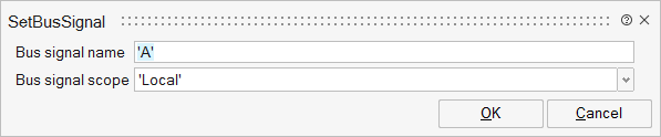

The "Bus Signal Scope" parameter defines the scope in which the implicit signal is defined. For more information, please refer to the GetSignal block.

Bus signal name
The name of the Bus Signal.
tagvis
Bus signal scope
The scope of the Bus Signal.
'Local'
'Scoped'
'Global'
