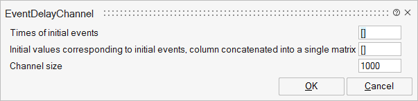

Times | Times of initial events | The time of initial events before any delay happens. | Matrix of size 1xN | |
initial_values | Initial values corresponding to initial events, column concatenated into a single matrix | Initial values corresponding to initial events. Concatenated in a single matrix where each column represents the initial values at given events. | Matrix | |
N | Channel size | The size of channel indicates how many events are kept before delay is done on earliest event, default is 1000. | Scalar |
