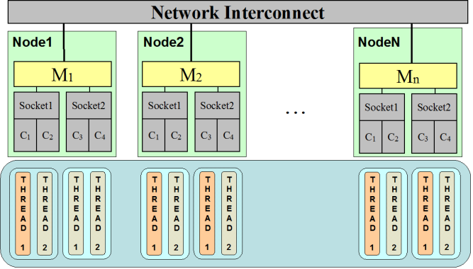

Figure 1. Hybrid Version Run with 2 SMP Threads per SPMD Domains
With the Hybrid version, it is easy to optimize the software to run on such complex architecture. Figure 1 shows that each SPMD domain is computed by a different processor. The number of threads per domain is set to the number of cores per processor (two).
So, each processor computes a SPMD domain using two SMP threads, one per core.

As seen in the example above, a good rule is to set the number of SPMD domains equal to the number of sockets and to set the number of SMP threads equal to the number of cores per socket.
With a low number of cores (below 32), a pure SPMD run might be more effective but the performance gap should be small if the setup explained above is respected.
With a very high number of cores (1024), it is possible to increase the number of SMP threads up to the number of cores per node and set only one SPMD domain per node to maximize performance if the limit of scalability of the interconnect network is reached.
