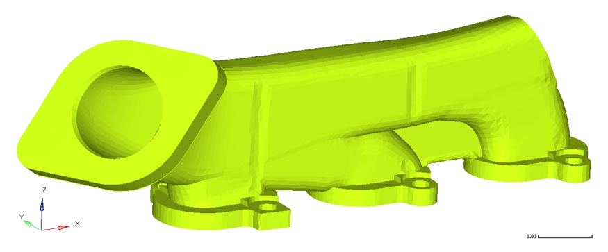

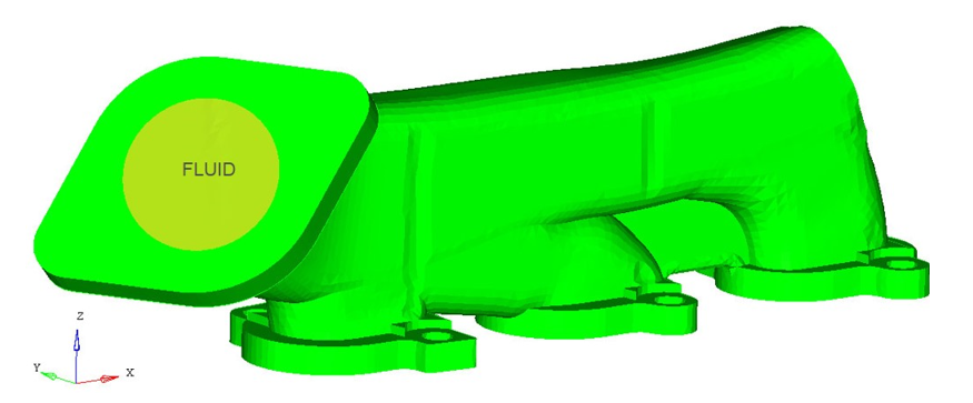

Figure 1. Fluid Structural Model

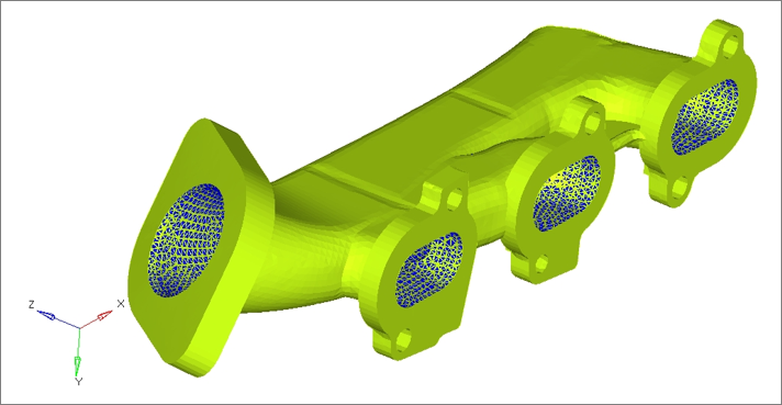

Create Contact Surface

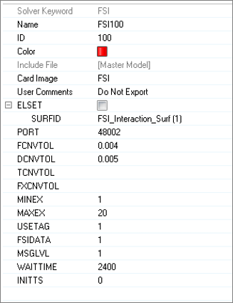

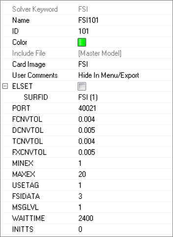

Define Fluid-Structure Interaction Parameters

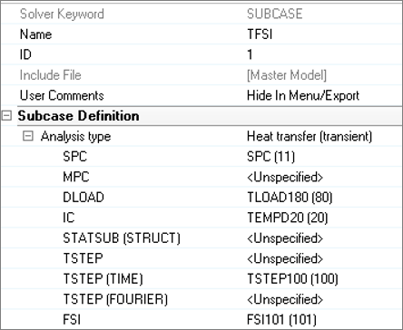

Create Transient Heat Transfer Analysis Subcase

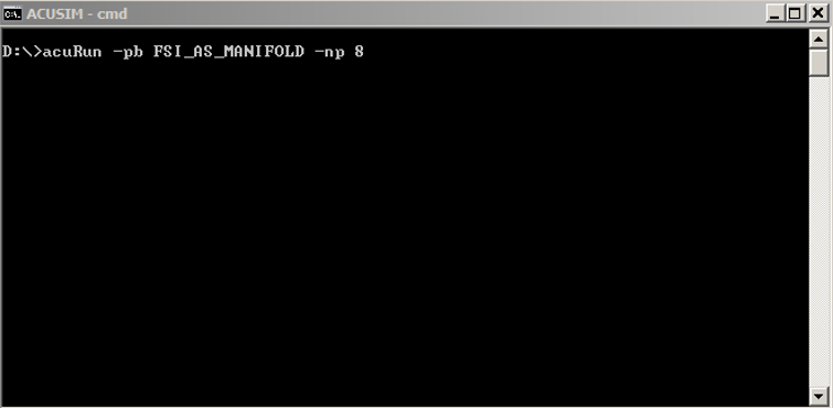

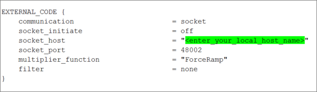

Submit the AcuSolve Job

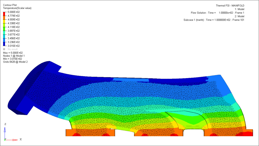

View the Results
Figure 9.
