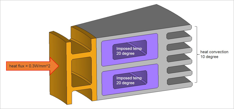

Model Description
The inner part is made of copper and the outer heat sink wall is made of aluminum. The outer heat sink wall comes into contact with the ambient air and heat convection.
The Finite element model consists of three different materials.

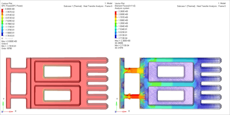

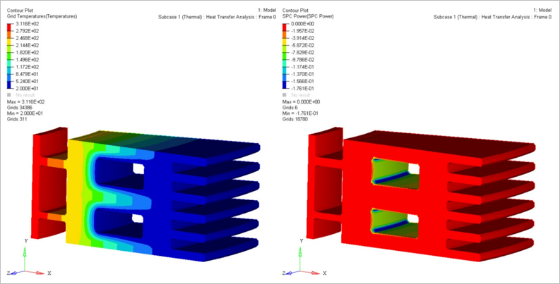

Results
Figure 2. Grid Temperature and SPC Power Contour
