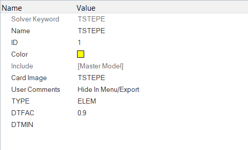

Create TSTEPE Load Collector
The time-step control parameters for explicit analysis is defined.

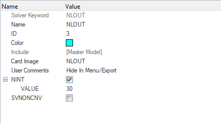

Create NLOUT Load Collector

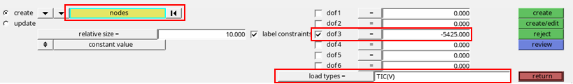

Create INI_VEL Load Collector
In this step, an initial velocity of 5425 mm/s will be applied to the phone in the negative Z direction.
