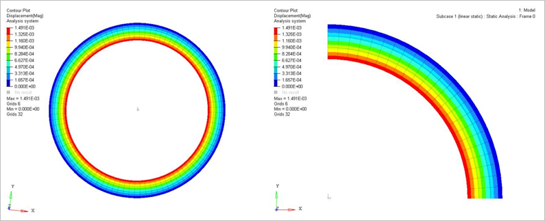

Results
Figure 2. Results of Full Model and Truncated Model are Identical
