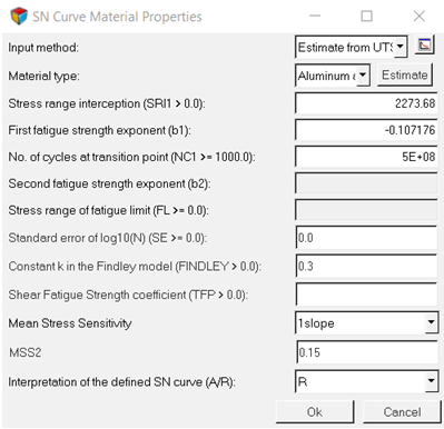

  6. Click SN Curve Material Properties.
    An SN Curve Material Properties dialog opens.
  7. For Input method of defining S-N curve, select Estimate From UTS.
  8. Click the Show SN curve definition icon 05_sn_curve.
    An SN method description window introducing how to generate the SN material parameter opens.
  9. Click Close.
  10. For Material type, select Aluminum Alloys and click Estimate.
    All the data for SN curve definition are automatically estimated.
  11. Click OK.

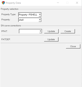

  14. Click Add Property.
    A Property Data dialog opens.
  15. For Property Type, select Property - PSHELL.
  16. For Property, select shell.
    This is the skin coating the solid control arm.
  17. Click Create to create create PFAT property.
  18. For LAYER, select TOP.
  19. For FINISH, select NONE.
  20. For TREATMENT, select NONE.
  21. Leave the field after KF (Fatigue strength reduction factor) set at 1.0.
  22. Click Close to save the definition of the SN data for the selected property.
  23. Click Close in the Property Data dialog to save the fatigue definition.

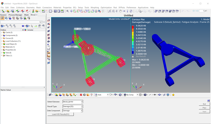

Post-process the Analysis
  1. Make sure the task Post-processing is selected in the Fatigue Analysis tree.
    When fatigue analysis has completed successfully after the previous submit, it will automatically go into this task.
  2. For Fatigue subcase, make sure Select Subcase is selected.
  3. For Result Type and Data Component, select the required data you want to contour from the drop-down menu.
  4. Click Load H3D Results (HV).
    This launches HyperView and loads the ctrlarm_fpmtut.h3d results file. It applies the result contour for selected result type and component. You can use HyperView for more detailed results.
  5. Click Exit to unload Fatigue Process Manager.
    rd2070b_life_results
    Figure 18. Post-Processing
    Figure 19. Damage Contour in HyperView
