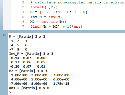

  1. Calculate inverse of a matrix.
    When a matrix is square and non-singular, the inverse is computed with the inv function:
    % calculate non-singular matrix inversion
    format(3,2);
    M = [1 2 -3;4 5 6;-7 8 0]
    Inv_M = inv(M)
    M2 = inv(inv(M))
    find((M - M2) > 10*eps)
    Results in Compose are shown below:

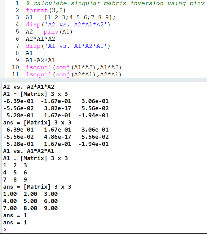

    Observe above that inv(inv(M)) is equal to M, within round off error. But when M is not a square or is a singular matrix, inv returns an error or a warning. Alternatively, you can calculate its Moore-Penrose inverse, or pseudoinverse. If A2 is the pseudoinverse matrix of M1, it should satisfy the following:
    A2*A1*A2 = A2
    A1*A2*A1 = A1
    conj(A1*A2) = A1*A2
    conj(A2*A1) = A2*A1
    Verify if it obeys all four rules in OML:
    % calculate singular matrix inversion using pinv
    format(3,2)
    A1 = [1 2 3;4 5 6;7 8 9];
    disp('A2 vs. A2*A1*A2')
    A2 = pinv(A1)
    A2*A1*A2
    disp('A1 vs. A1*A2*A1')
    A1
    A1*A2*A1
    isequal(conj(A1*A2),A1*A2)
    isequal(conj(A2*A1),A2*A1)

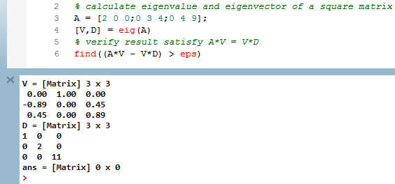

  2. Calculate Eigenvalues and Eigenvectors of a matrix.
    An Eigenvalue of a square matrix is a vector, , that does not change direction under a linear transformation with the matrix, which can be described with the following equation:
    where is a scalar known as the eigenvalue associated with the eigenvector . In OML, use the eig function to compute this.
    % calculate eigenvalue and eigenvector of a square matrix
    A = [2 0 0;0 3 4;0 4 9];
    [V,D] = eig(A)
    % verify result satisfy A*V = V*D
    find((A*V - V*D) > eps)
