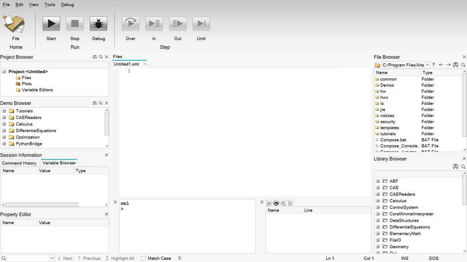

This launches Compose in the GUI mode. Notice that by default, a file named Untitled1.oml exists in the Editor window. By default, the Authoring Mode is displayed as well.

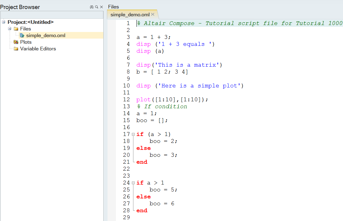

  1. From File menu, click Open File, or use the Open File icon,
  2. From the Open File dialog, browse to the following folder location: <installation_dir>/tutorials/.

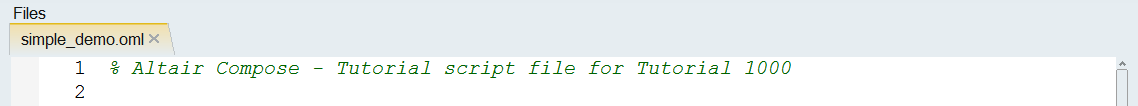

    Select the file simple_demo.oml and click Open.
    This opens a new tab in the Editor window titled simple_demo.oml. This tab is now the active tab, indicating that this file is the active file.

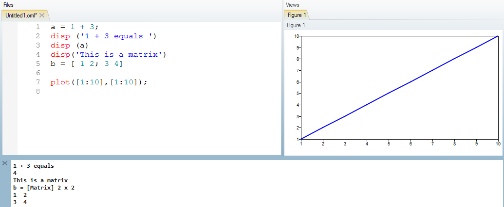

  1. In the Editor window, type a = 1 + 3 and press Run.
    If we type a ';' we can suppress this output.
    You’ll notice that this time, nothing is displayed in the output yet there is the variable 'a' in the Variable Browser.
  2. On the next line, type disp ('1 + 3 equals '); disp (a); and then run the script.
    This forces the output to display the value of 'a'.
  3. Press Enter and then add the following two lines to assign a matrix to 'b' :
    disp('This is a matrix')
    b = [ 1 2; 3 4]
    Without the ';' the matrix is displayed just like 'a' was. Click Run again. The following is displayed:
  4. To create a simple plot, type plot([1:10],[1:10]); and click Run.
    A linear plot is displayed.

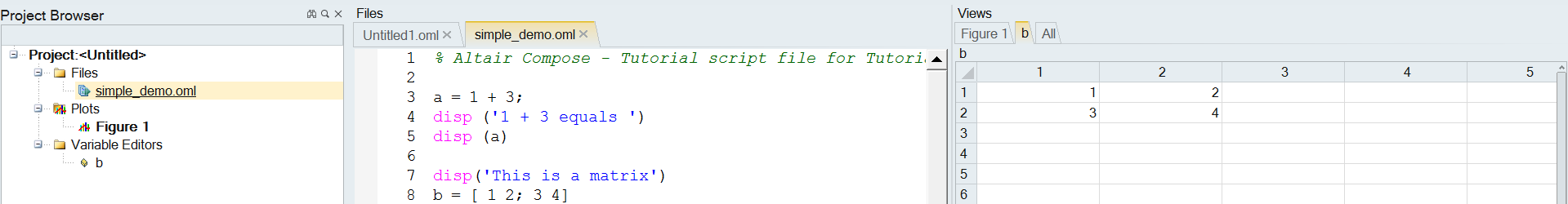

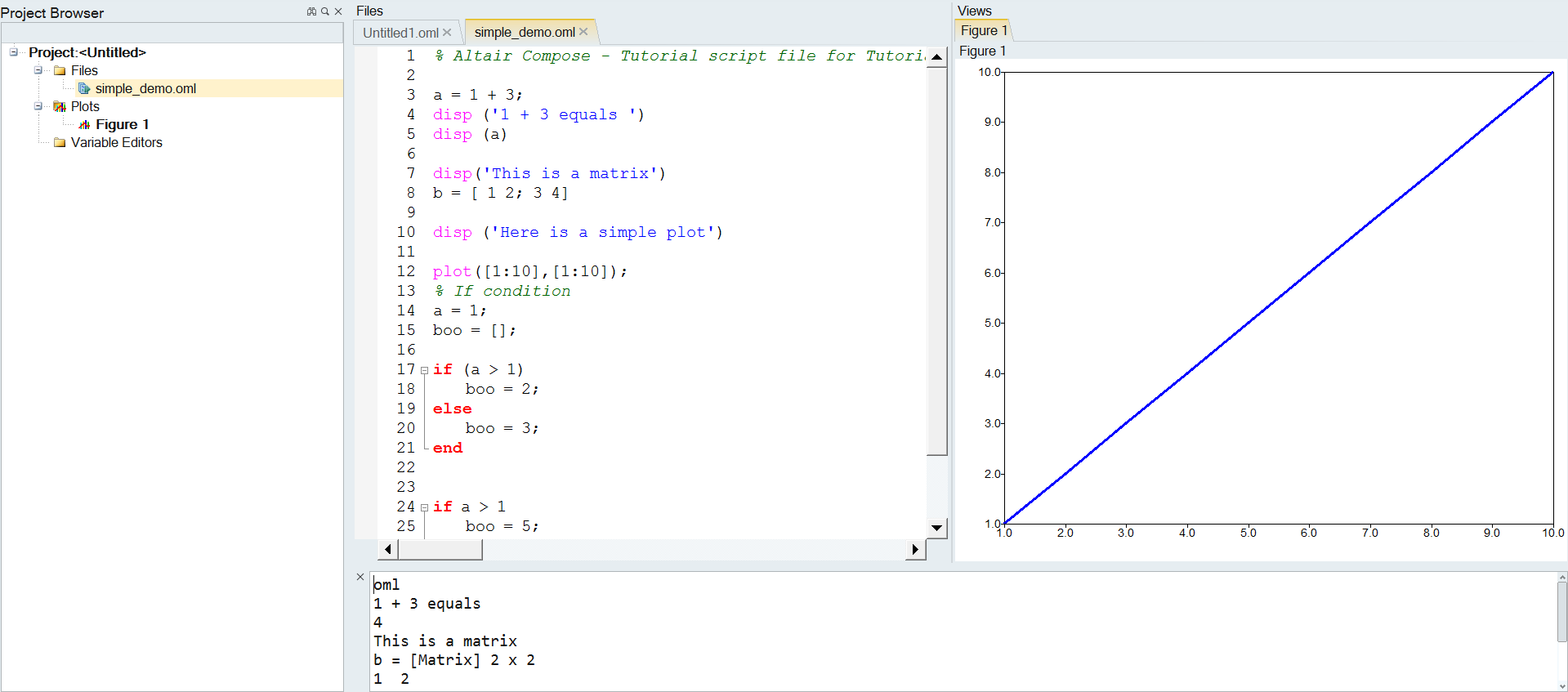

  2. Right-click Files > Add Existing File and navigate to simple_demo.oml. The simple_demo.oml file is added to the Project Browser.
  3. Double-click the OML script to open it in the Editor.
  4. Run the file as previously outlined and you’ll notice that the plot Figure 1 was added to the Plots.
  5. To add the Matrix Editors, navigate to View > Variable Browser and double-click the matrix variable b that we defined earlier. Notice now that b is added the Matrix Editors and can be modified by the matrix editor tile.
