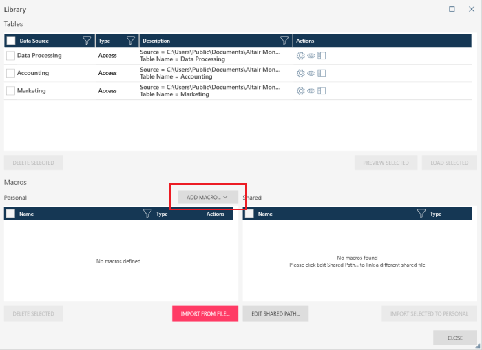

  1. Click on the Data Source Library icon in the Data Prep Studio toolbar.
    The Data Source Library displays.
  2. Click Add Macro... as shown below.
  3. From the options that display, select TEXT MACRO.

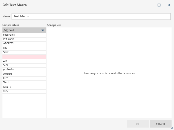

    The Edit Text Macro dialog displays
    The Sample Values column shows combinations of text formats that you can clean.

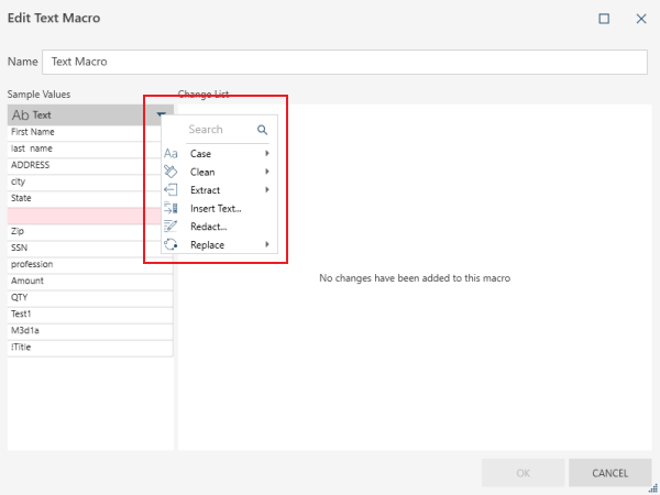

  4. Click the drop-down icon located to the right of the Text field in the Sample Values column and then select a data-prep operation to apply to your text field.
    You can apply the following changes to text columns as macros:
    Change Type
    Details
    Case
    • Make Proper Case
    • Make Lower Case
    • Make Upper Case
    Clean
    • Remove Leading & Trailing Spaces
    • Remove Consecutive Spaces
    • Remove Specified Characters
    • Remove Non Alphanumeric Characters
    • Remove Numeric Characters
    • Remove Alpha Characters
    Extract
    • Starting from Left
    • Starting from Right
    • Using Position & Length
    • Between Start & End Text
    Insert Text
    Redact
    Replace
    • Ditto
    • Nulls
    • Blank Values
    • Using Find and Replace
    • Using Position and Length

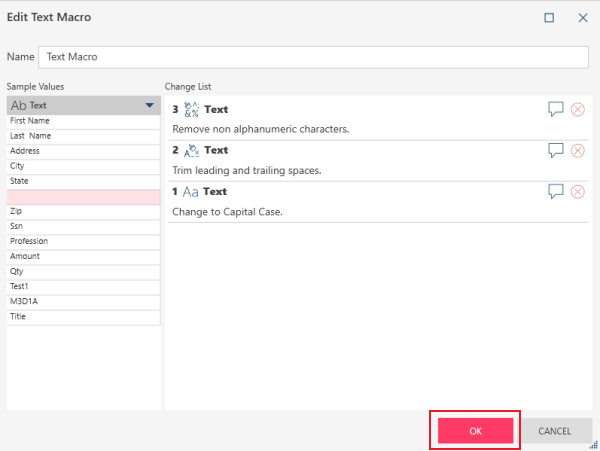

  5. When you have finished selecting the changes you wish to apply to your text columns, click OK.

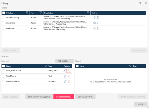

Deleting Macros
All of the macros you have created display in the Macros list of the Data Source Library.
To delete a macro, select the Delete icon located to its right.
Close the Data Source Library when you are finished.
