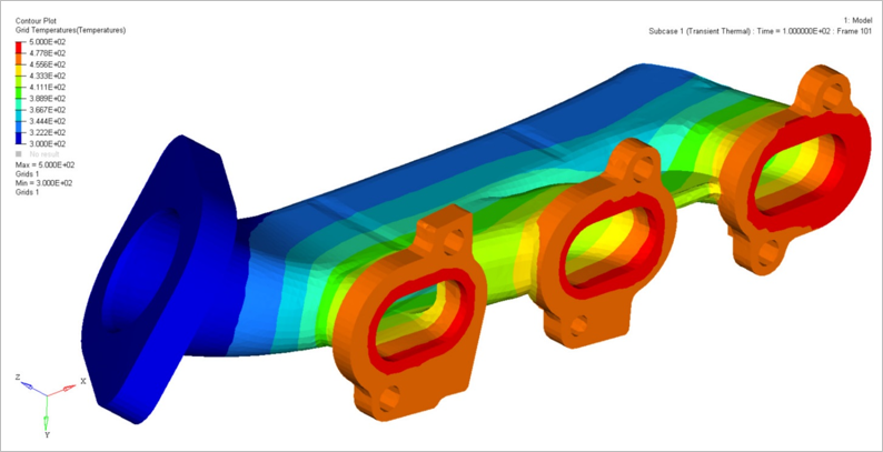

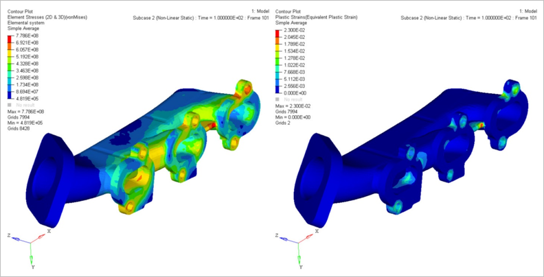

From OSTTS (One Step Thermal Transient Stress) results, you can see the thermal results
from the subcase 1 (Thermal Transient) as in Figure 2 and the Stress
results from subcase 2 (NLSTAT) as in Figure 3.
