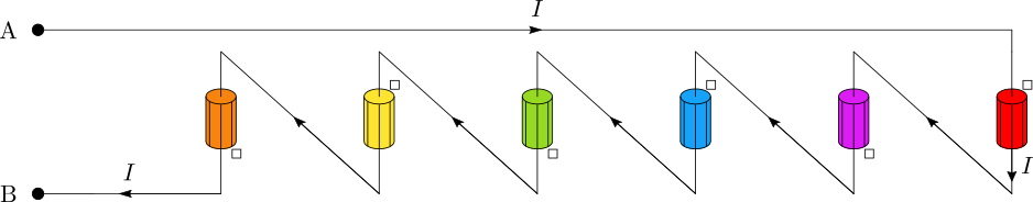

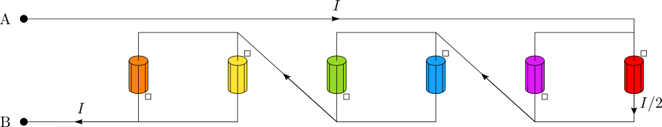

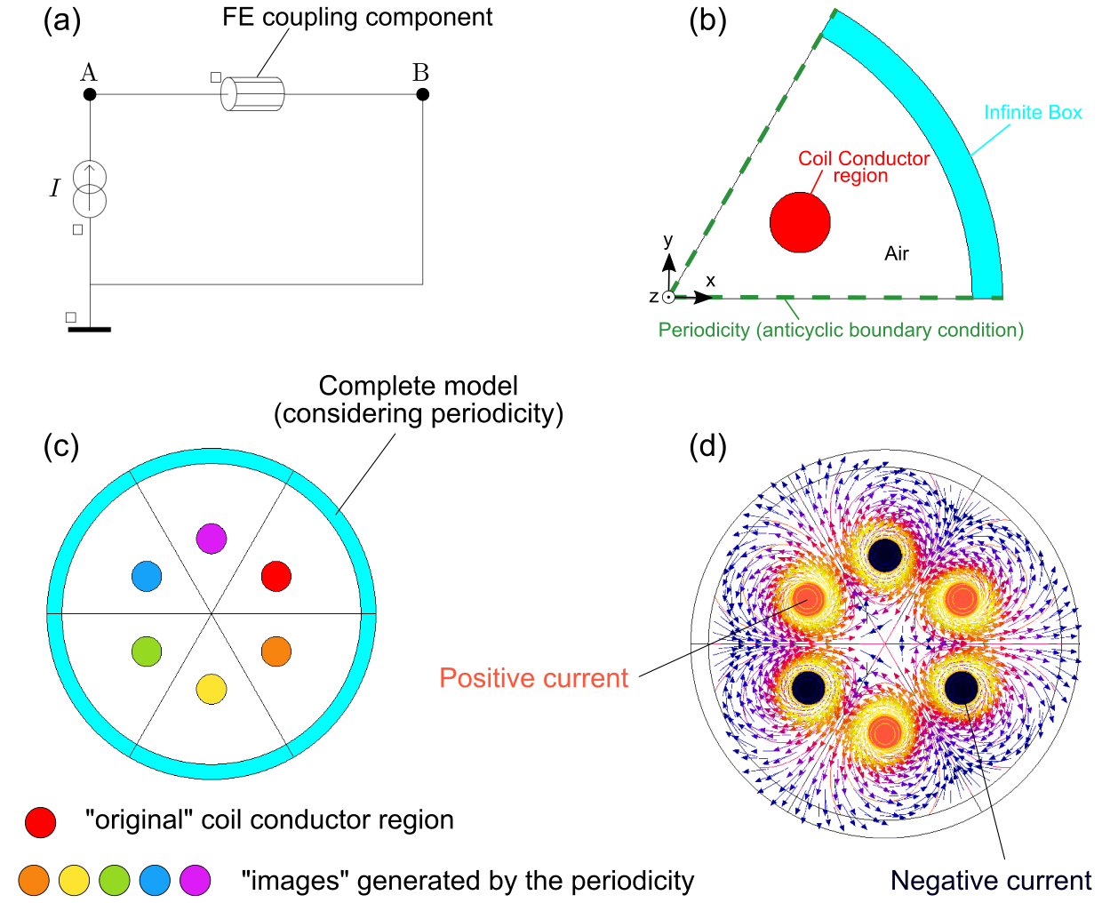

The example provided in Figure 2 illustrates the different available possibilities for the case of a coil conductor region in Flux 2D. The coil represented by the FE coupling component in Figure 2(a) is distributed to create a 6-pole winding, which is fed by the current source displayed in the external circuit. A periodicity (rotation about the Z axis, number of repetitions = 6, odd periodicity/anticyclic boundary condition) was employed to simplify the description of the model, which is limited to one-sixth of the winding, as shown in Figure 2(b) . The full winding is represented in Figure 2(c): while the original coil conductor region is displayed in red, its images are represented in other colors.
Figure 2. A distributed, six-pole winding modeled in Flux 2D with a coil conductor region: (a) the circuit view, (b) its 2D model simplified by the use of a periodicity and (c) the complete winding showing the associated periodical images. The magnetic flux density distribution and the sense of the current flow are shown in (d).

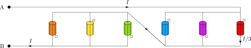

As already stated, different associations linking the "original" coil conductor and its "images" are possible. Table 1 lists all the coherent associations for the example of Figure 2. Notice that the same color convention established in Figure 2(c) was used in the circuits of that table.
Table 1. Possible associations between periodical conductors in the example.
Symmetries and Periodicites: number of conductors in series or in parallel Equivalent circuit association between conductors
All in series or Number of symmetrical and periodical conductors in parallel = 1
Number of symmetrical and periodical conductors in parallel = 2
Number of symmetrical and periodical conductors in parallel = 3
All in parallel or Number of symmetrical and periodical conductors in parallel = 6
It should also be remarked that terminals A and B marked on the circuits of Table 1 correspond to the terminals of the FE coupling component shown in Figure 2(a). Consequently, while the FE coupling component is always traversed by the same current, the current actually flowing in the coil conductor region (and in each of its periodical images) depends on the connection scheme chosen by the user.
In the previous example, for a current I fed to the FE coupling component by the external circuit, the current flowing in the coil conductor region and in its images may be either ± I, ± I/2, ± I/3 or ± I/6, according to Table 1. As a result, the magnetic flux density distribution displayed in Figure 2(d) also depends on the connection scheme adopted by the user: the field intensities computed by Flux2D will also be scaled by the factors 1, 1/ 2, 1/3 or 1/6 affecting the current intensities, depending on the case.

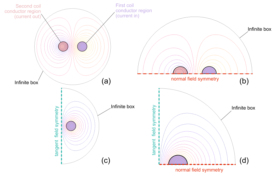

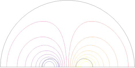

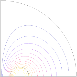

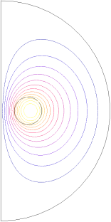

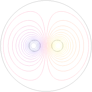

The example in Figure 3 illustrates how symmetries may be combined in Flux to simplify the modeling of electromagnetic devices. That figure shows a single coil modeled in Flux2D using four different approaches:
  • (a) without the use of symmetries;
  • (b) with a single normal field symmetry along the horizontal plane;
  • (c) with a single tangent field symmetry condition along the vertical plane;
  • (d) with a tangent field symmetry condition along the vertical plane and a normal field symmetry condition along the horizontal plane.
Figure 3. Four different strategies to model a coil in Flux2D: (a) without any symmetries, (b) with a normal field symmetry, (c) with a tangent field symmetry and (d) with both normal and tangent field symmetries.
As already mentioned, the same coil may be represented in Flux by any of these strategies. Depending on the specific context, one of them may be more convenient or justifiable than the others. In any case, the user should keep in mind that the number of coil entities required and their internal settings may be slightly different due to the combination of symmetries in the project.
For instance, the number of coil conductor regions required to completely represent the winding of Figure 3 in Flux2D is affected by the existence of tangent field symmetries (representing the physical condition at the coil axis) as follows:
  • two independent coil conductor regions are required (with opposite orientations) when no tangent field symmetries are present, as in cases (a) and (b) of Figure 3.
  • only one coil conductor region is required when a tangent field symmetry is present, as in cases (c) and (d) of Figure 3.
On the other hand, the number of turns provided during the creation of a coil conductor region depends on the existence of normal field symmetries. If the real coil being modeled has N turns:
  • the number of turns in the coil conductor regions should be set to N/2 if a normal field symmetry plane is present, as in cases (b) and (d) of Figure 3.
  • the number of turns in the coil conductor regions should be set to N in the absence of a normal field symmetry plane, as in cases (a) and (c) of Figure 3.
