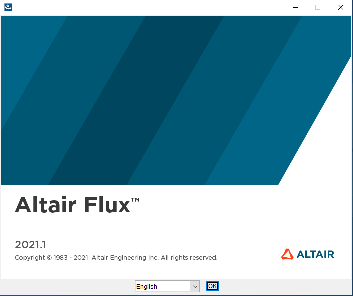

  3. Run the executable file hwFlux2021.1_win64.exe
    • Select a language
    • Click on the OK button

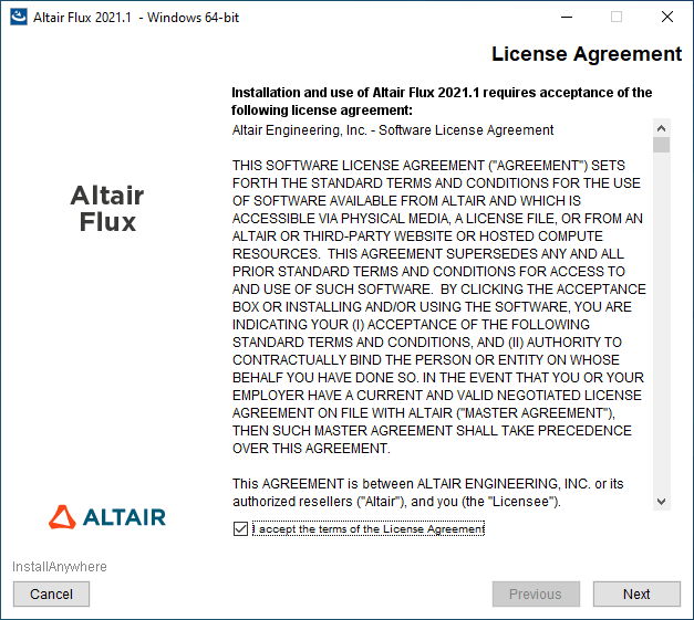

  4. In the Altair Flux 2021.1 – Windows 64-bit window (License Agreement panel):
    • Scroll through the license agreement and if you accept the terms of the License Agreement, then check the I accept the terms of the License Agreement box
    • Click on the Next button to install Flux 2021.1

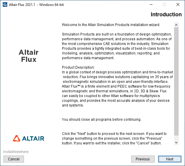

  5. In the next Altair Flux 2021.1 – Windows 64-bit window (Introduction panel):
    • Click on the Next button to continue installing Flux 2021.1

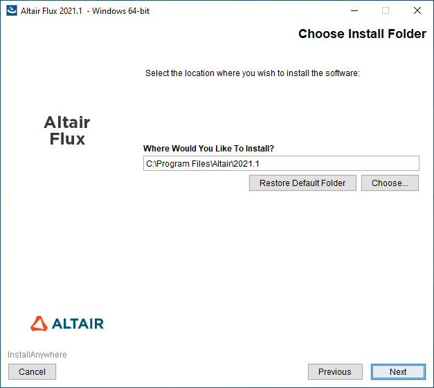

  6. In the next Altair Flux 2021.1 – Windows 64-bit window (Choose Install Folder panel):
    • Choose an installation directory:
      • By default:
        • with a user account: the installation directory is C:\Users\<username>\Altair\2021.1
        • with an administrator account: the installation directory is C:\Program Files\Altair\2021.1
      • You can specify another installation directory, however, make sure that the full directory path does not include any special characters, then click on the Choose button

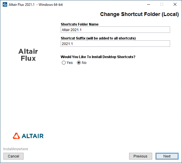

  7. In the next Altair Flux 2021.1 – Windows 64-bit window (Change Shortcut Folder (Local) panel):
    • Specify the folder name that will contain the start menu shortcuts.
    • Specify the suffix string to be added to the shortcuts (Optional).
    • Select one of the following options:
      • Yes if you want to add the Flux shortcut on the desktop
      • No if you do not want to add the Flux shortcut on the desktop

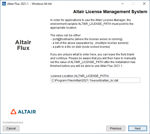

  8. In the next Altair Flux 2021.1 – Windows 64-bit window (Altair License Management System panel):
    • Enter the license location:
      • If you have a network license, then enter port@hostname
        where port is the TCP/IP port number used by the license server and hostname is the name of the license server computer
      • If you have a local license (standalone license), then enter the full pathname of the license file
    Note: This window is only displayed if the license has not yet been configured.

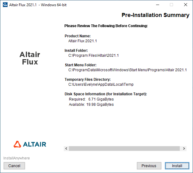

  9. In the next Altair Flux 2021.1 – Windows 64-bit window (Pre-Installation Summary panel):
    • Click on the Install button to start the Flux 2021.1 installation

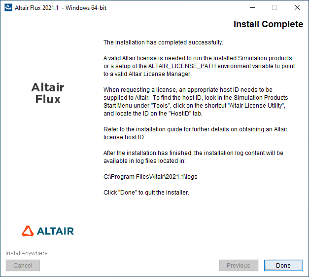

  10. In the last Altair Flux 2021.1 – Windows 64-bit window (Install Complete panel):
    • Click on the Done button to complete the Flux 2021.1 installation
