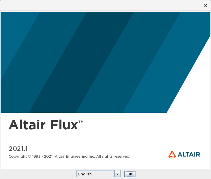

  3. Execute the file hwFlux2021.1_linux64.bin
    • Select a language
    • Click on the OK button

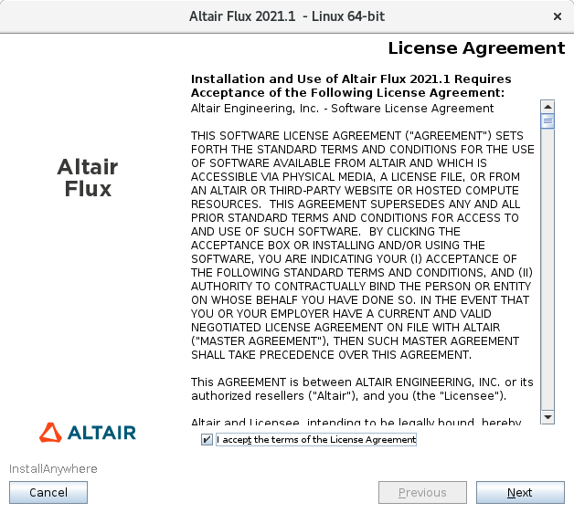

  4. In the Altair Flux 2021.1 – Linux 64-bit window (License Agreement panel):
    • Scroll through the license agreement and if you accept the terms of the License Agreement, then check the I accept the terms of the License Agreement box
    • Click on the Next button to install Flux 2021.1

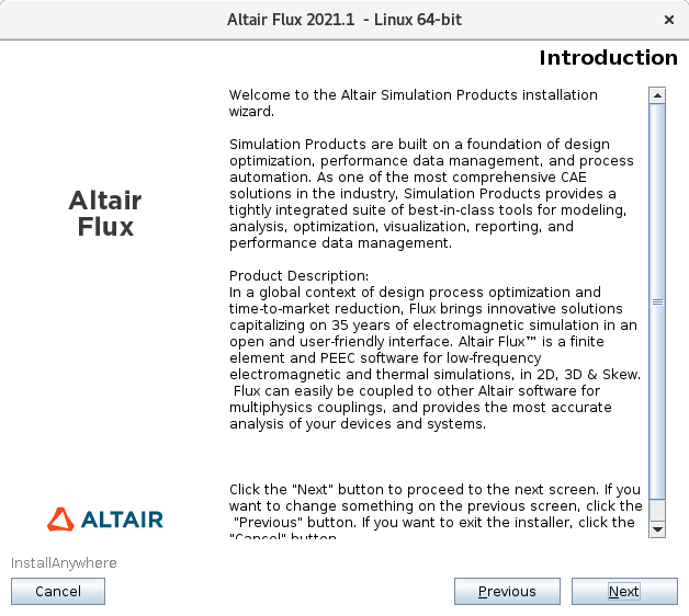

  5. In the next Altair Flux 2021.1 – Linux 64-bit window (Introduction panel):
    • Click on the Next button to continue installing Flux 2021.1

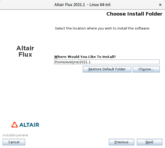

  6. In the next Altair Flux 2021.1 – Linux 64-bit window (Choose Install Folder panel):
    • Choose an installation directory:
      • By default:
        • with an unprivileged account: the installation directory is /home/<username>/2021.1
        • with the root account: the installation directory is /root/2021.1
      • You can specify another installation directory, however, make sure that the full directory path does not include any special characters, then click on the Choose button

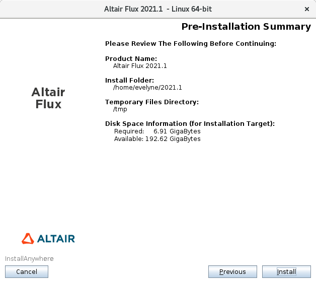

  7. In the next Altair Flux 2021.1 – Linux 64-bit window (Pre-Installation Summary panel):
    • Click on the Install button to start the Flux 2021.1 installation

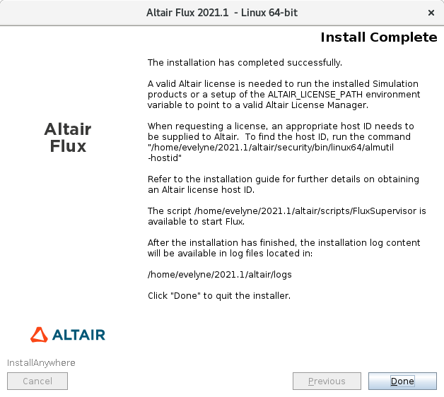

  8. In the last Altair Flux 2021.1 – Linux 64-bit window (Install Complete panel):
    • Click on the Done button to complete the Flux 2021.1 installation
