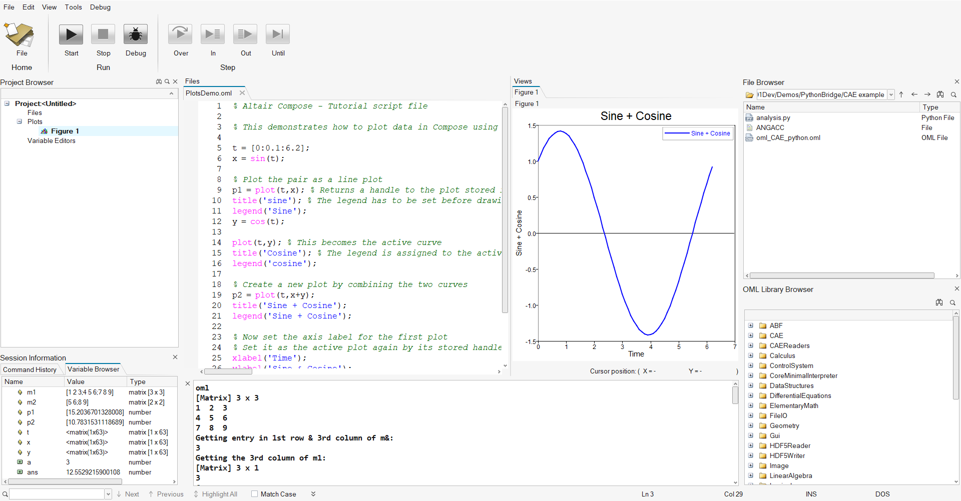

In Compose, you can create 2-D and 3-D plots using OML plotting commands.
OML Plots
In Compose, the OML language offers a rich set of plotting commands for both 2-D and 3-D plots.
Examples and syntax can be found in the OML Reference Guide > Plotting section.
In Compose, 2-D or 3-D plots can either be displayed in the plot area, or they can be detached and floating.

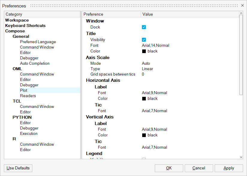

By default, the plots are in the plot area. This can be modified in the Preferences panel:
Figure 4.

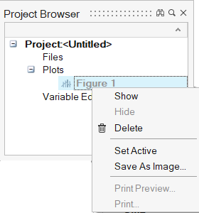

Plots (called figures) can be managed from the Project Browser:
Figure 5.
All figures are listed and can be show, hidden, exported to an image, deleted, or printed.

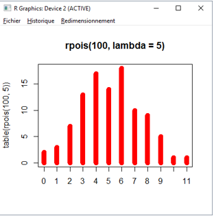

Compose supports R language plot commands.
The default option is to rely on the MATPLOTLIB implementation provided by R.
The following script creates the plot (floating figure) shown below.
plot(table(rpois(100, 5)), type = "h", col = "red", lwd = 10, main = "rpois(100, lambda = 5)")
Figure 6.

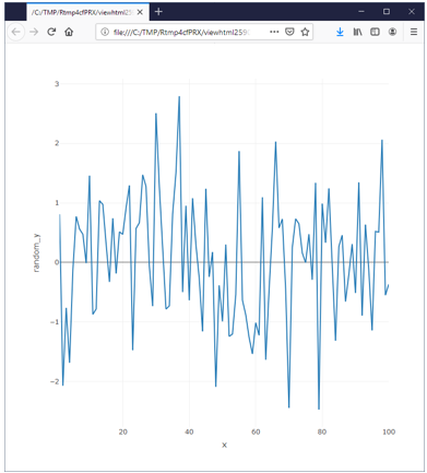

The second option is to leverage the PLOTLY library in R.
For example, the following script creates data and plots it in a new Internet browser window.
library(plotly)
x <- c(1:100)
random_y <- rnorm(100, mean = 0)
data <- data.frame(x, random_y)
p1 <- plot_ly(data, x = ~x, y = ~random_y, type = 'scatter', mode = 'lines')
pl
Figure 7.
