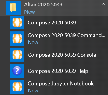

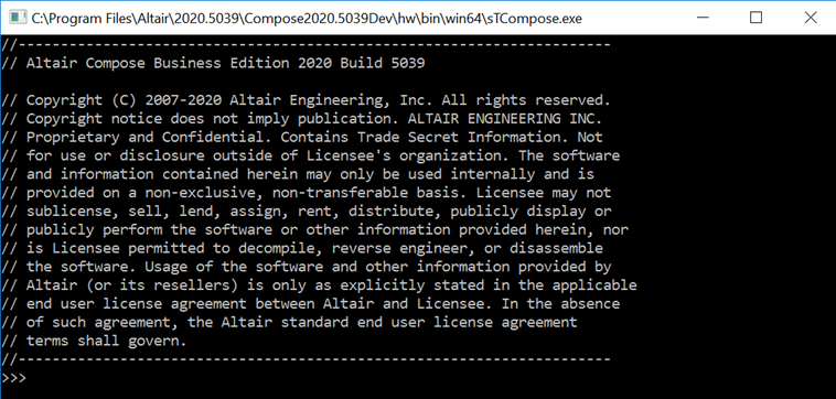

  1. To open Compose in console mode, go to All Programs > Altair 2021.1 > Compose 2021.1.
  2. A command window with the Compose application running in Console mode is open as shown below:

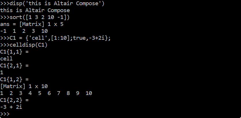

    From here, all commands (except plot-related) are available. Type any command at the prompt and press ENTER to evaluate them immediately.

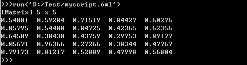

  3. You can also run a script or function file in Console mode using the run function.
    Assume a script named myscript.oml exists under D:/Test and contains these commands:
    M1 = rand(5,5);
    disp(M1)
    Run this in Console mode, and check the results:

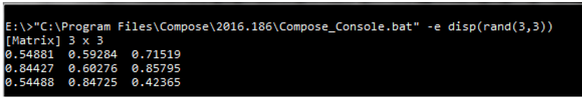

  4. OML commands can be directly executed using the –e option. Following the Compose_Console.bat command, type –e "Any valid OML command". For example:
    Compose_Console.bat –e disp(rand(3,3))
    This prints a 3x3 matrix in the command prompt:
    Use quotes to run multiple commands and/or commands including spaces.

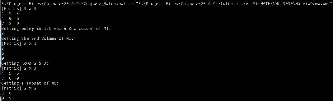

  5. OML scripts can be directly executed using the –f option. Following the .bat command, type –f and the path to the file MatrixDemo.oml. This should look like the following:
    Compose_Console.bat –f <installation_dir>\tutorials\MatrixDemo.oml
    Press ENTER to run the file. Notice how all the output is displayed to the command prompt. Also, the output is the same as what was displayed in Compose in the OML Command window when the script file was evaluated.

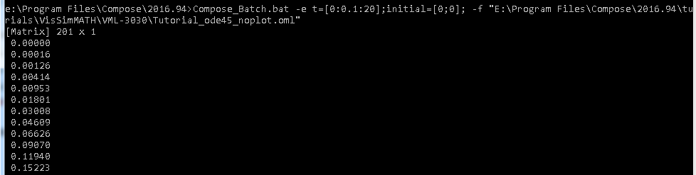

You can define input arguments between –e and –f, and they will be inherited into the script afterward. Run the example below:
Compose_Console.bat –e t=[0:0.1:20];initial=[0;0]; –f
<installation_dir>\tutorials\ode45_noplot.oml
The script file ode45_noplot.oml is located under <installation_dir>/tutorials/. Note that if you run the script file directly in the Compose GUI, it will prompt that variable t and initial are not defined. See the result when running the correct command in batch:

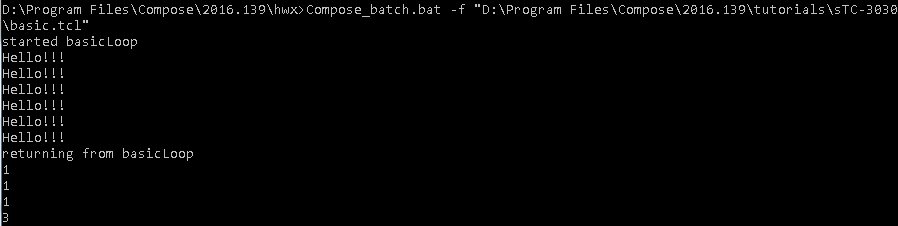

Compose also supports also multiple languages. To run a Tcl script in batch, enter the following:
<installation_dir\hwx\Compose_Batch.bat –f <TCL file with .tcl extension
See the result of running basic.tcl in batch mode:
