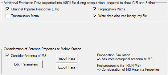

To include a directional receiver antenna pattern and obtain the actual received power, click tab. Under Consideration of Antenna Properties at Mobile Station, select the Consider Antenna of MS check box. Here, MS stands for mobile station, but it can be any receiving antenna.
Note that the Propagation Paths check box is also selected to save the propagation paths during the regular propagation part of the simulation. This is automatic when you select the Consider Antenna of MS check box because the algorithm has to know, at every potential receiver location (at every pixel in the result plot), from which directions the signals are arriving. Only then can the receiver antenna pattern be included properly.
Click Edit Parameters to specify the receiving antenna pattern and other mobile station settings.
Figure 1. The Edit Project Parameters dialog where you can request the consideration of the receiving antenna.

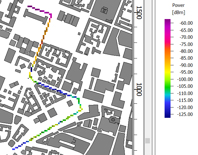

The result is, among other quantities, the actual received power for the receiving antenna. In trajectory mode, the result might look like Figure 3.
Figure 3. Example result of a virtual drive test.
This type of simulation is called a virtual drive test, since it is as if the receiving antenna were being driven along the trajectory. It is not a time-variant simulation, however, since no geometrical objects in the model move with time.
