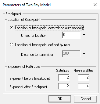

Figure 2. The Parameters of Two Ray Model dialog.
The Breakpoint describes the physical phenomenon that further than a certain distance the received power decreases with instead of which is valid for the free space propagation. This is due to the superposition of the direct ray with a ground reflected contribution.
- Exponent before breakpoint / Exponent after breakpoint
- These two exponents influence the calculation of the distance-dependent attenuation. The default values are 2 for the exponent before the breakpoint and 4 for the exponent after the breakpoint.
- (Additional) breakpoint offset
- The breakpoint distance depends on the height of the transmitter and receiver as well as the wavelength (the initial value is calculated according to ). This value can be modified by setting an additional offset (in meters).
