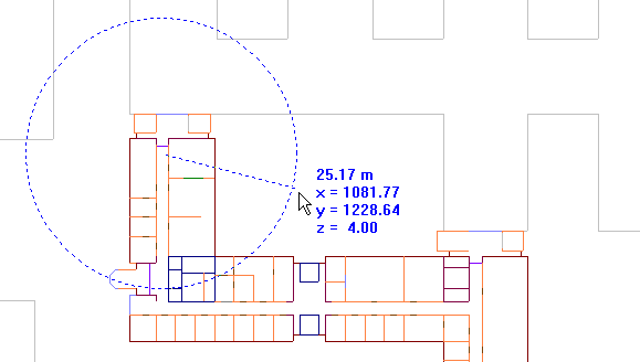

When the reference point selection is done and the mouse is moved, a blue dotted circle and a blue dotted line will appear. The line shows the direct connection of the reference point to the currently selected viewpoint. The circle shows the location of all points that are equidistant to the selected reference point. The line can be activated or deactivated pressing the “L” key on the keyboard. In the same way, the circle can be activated or deactivated by the “C” key. Beneath the mouse cursor position, a textual information will show the coordinates of the current mouse cursor position and the distance to the selected reference points in meters.
Figure 1. Mouse meter tool for distance measurement in WallMan.
