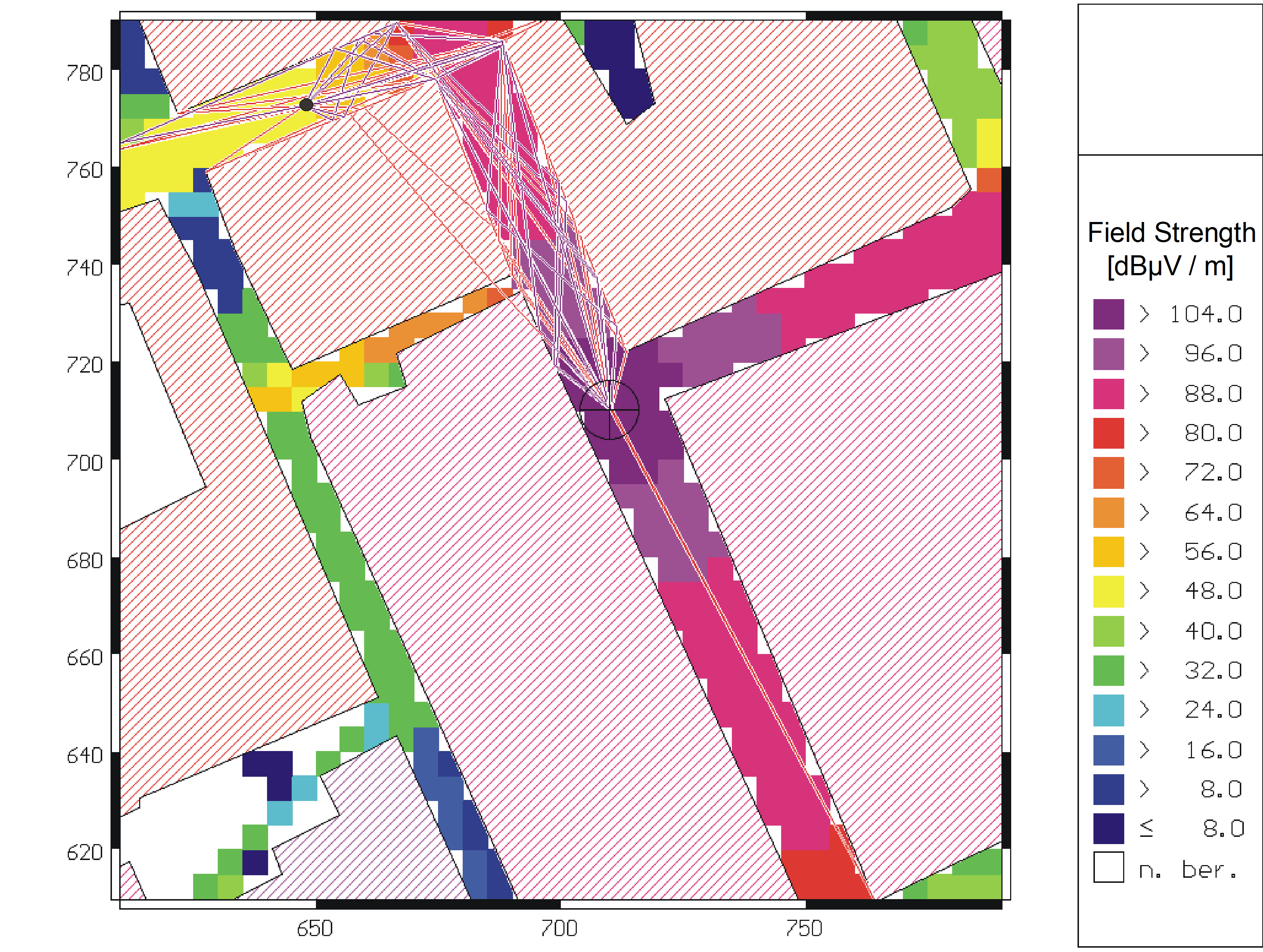

- The number of cases where neighboring receiving points are hit by rays for which the paths differ only slightly. For example, every receiving point in a street orthogonal to the street in which the transmitter is located is hit by a double reflected, single vertically diffracted ray and the points of interaction of these rays with walls and edges are independent of the receiver position (see Figure 1).
Based on these considerations it is possible to accelerate the time-consuming process of ray pathfinding by a single intelligent preprocessing of the database for buildings.
Figure 1. Rays between transmitter and receiver determined by ray-tracing.

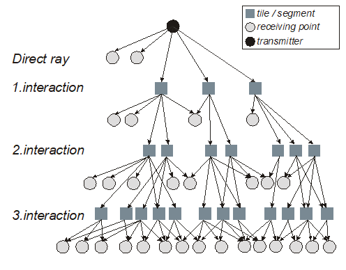

The result of the preprocessing of the building database is a tree structure containing tiles, segments and receiving points of the prediction area, for example, as indicated in Figure 3. In this tree, every branch symbolizes a visibility relationship between two elements.
For the prediction only the tiles, segments and receiving points, which are visible from the base station, have to be determined. Also, the angles of incidence for the visible tiles and segments have to be calculated. Subsequently, pathfinding can be done similar to the ray launching algorithm by recursively processing all visible elements and checking if the specific conditions for reflection or diffraction are fulfilled. The ray search is stopped if a receiving point or a given maximum number of interactions is reached. Finally, the field strength is summed up at all potential receiving points.
Figure 3 shows the arrangement of all visibility relations computed in the preprocessing and the prediction.
The preprocessing of the building database reduces the time-consuming process of pathfinding to the search in a tree structure. A comparison between the number of branches in the first layer (determined in the prediction) with the number of branches in the remaining layers (determined in the preprocessing) in the tree structure given in Figure 3 indicates the relation between the computational effort in the prediction and the computational effort in the preprocessing.
Figure 3. Determination of ray paths by searching in a tree structure.
Due to the small number of visibility relations in the first layer of the tree, the computation times are very short. Most of the time is spent on reading the visibility data from a file. If more than one transmitter is considered at the same time, the preprocessed data must only be read once and thus the prediction of the second transmitter is even faster than the prediction of the first transmitter because the visibility tree is already loaded into memory.

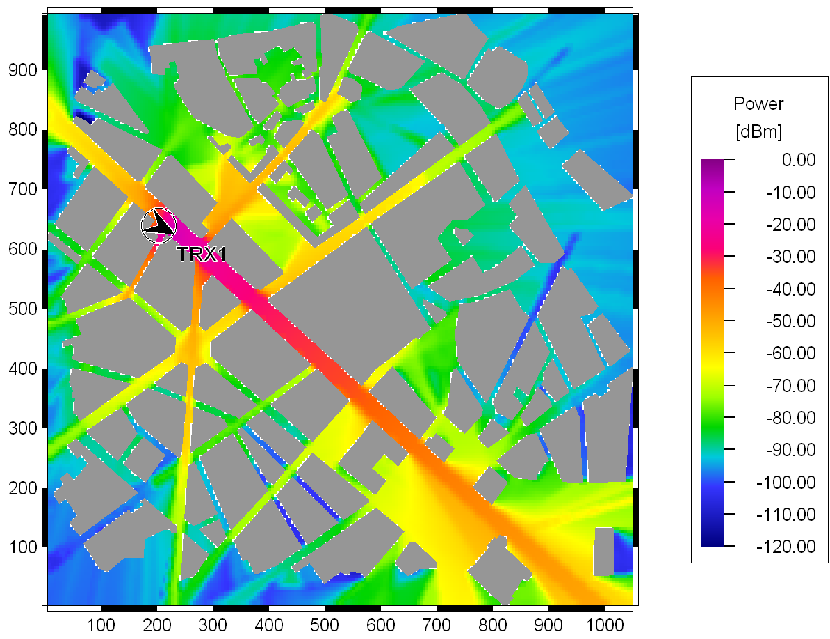

Figure 4. Prediction of the received power with intelligent ray-tracing.
A comparison of this prediction with preprocessing of the database on the one hand with a prediction calculated with the standard 3D ray-tracing, on the other hand, leads to very small differences.
