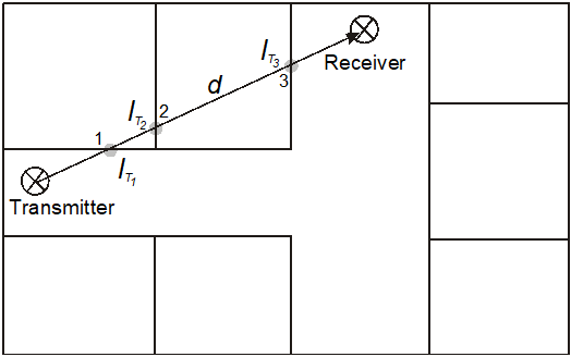

The multi-wall model gives the path loss as the free space loss including losses introduced by the walls and floors in the direct path between transmitter and receiver (see Figure 1). It has been observed that the total floor loss is a function of the number of penetrated floors. This characteristic is taken into account by introducing an additional empirical correction factor.
![](../../../../images/winprop/user_guide/propagation_models/multi_wall_model.png)
Figure 1. Principle of the multi-wall model.
The individual penetration losses for the walls (depending on their material parameters) are considered for the prediction of the path loss. Therefore the multi-wall model can be expressed as follows:
