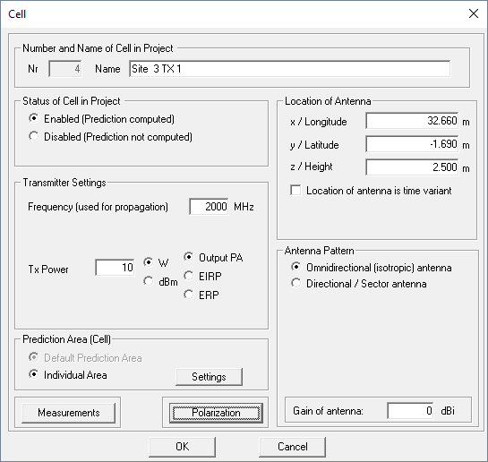

These transmitters have the following settings:
Figure 1. The Cell dialog to adjust isotropic transmitter settings.
- Number (Nr)
- The number of the transmitter is the internal ID and used by ProMan to separate the transmitters of one project. This is not relevant for the project settings.
- Name
- The name of the antenna/transmitter is important because it is added to the basic
output file name. If the basic output file name is xy and the
antenna name is TRX 1 the results will be saved in files
xy_TRX 1.*. Concerning the name of the antenna the following
rules must be considered:
- Only characters which are allowed in file names can be used.
- The name must be unique within the project to avoid collisions with other transmitters.
- Status of Cell/Transmitter in Project
- The transmitter can be enabled or disabled. Only enabled transmitters will be
computed. If no modifications were made, the transmitter can be disabled to save
computation time and so only the modified (and enabled) transmitters are computed
when starting the computation. The transmitter status can also be changed via the
project toolbar using the
icon and by clicking with the mouse on
the transmitter. The individual cells within the project can be included or excluded
from the network optimization process. - Transmitter and Receiver Settings
- The frequency is defined in this section as well as the output power (which is
required for the determination of the received power or field strength). The output
power can either be defined in Watt or dBm and the output power can be defined either
as the output power of the PA (power amplifier), as ERP (equivalent radiated power,
for example, relative to dipole antenna), or as EIRP (equivalent isotropic radiated
power, for example, relative to isotropic antenna). If G is the gain of the antenna
(in dBi), the values can be determined via the following equation:
- Prediction Area (Cell / Transmitter)
- Default Prediction Area
- Individual Prediction Area
- Measurement
- This option can be switched on if measurement data is available for the transmitters included in the project for calibration. This feature allows to automatically calibrate the wave propagation model based on imported measurement data. Supported measurement files are power results (.fpp), field strength results (.fpf) and path loss results (.fpl). The files are generated during the propagation prediction and not during the network computation. These files can then be processed with a separate stand-alone tool to derive the calibrated settings for the propagation exponents (before / after the breakpoint for LOS/NLOS conditions).
- Polarization
- When using GTD/UTD and Fresnel coefficients for the calculation of diffractions or reflections and transmissions, respectively, arbitrary linear polarizations (between +90° and –90°) can be considered for the ray-tracing models (SRT & IRT), the dominant path model and the empirical multi-wall model. The corresponding polarization can be defined for each Tx antenna individually.
Figure 2. The Polarization dialog.
Rural and urban wave propagation simulations do not consider individual polarizations, except if the IRT model is used. If the urban IRT model is not used, vertical polarization is assumed for all transmitters. For rural and urban network planning projects, polarization is only taken into account for the computation of co-channel interference and is not considered during wave propagation prediction.
- Location of antenna
- Location coordinates of the antenna. The same coordinate system as used for the
database must be used. The coordinates can be entered in the dialog, or the
transmitter can also be moved/placed with the mouse via the menu : Move or via the toolbar using the
icon. - Type of antenna
- Select between an isotropic antenna or a directional / sector antenna. An antenna pattern must only be defined if the directional antenna is enabled. If omnidirectional antennas should be considered, an isotropic antenna can be selected, and the gain of the omnidirectional antenna can be added to the EIRP value of the output power.
- Antenna Pattern
- Not available.
- Vertical Orientation
- Not available.
- Horizontal Orientation
- Not available.
