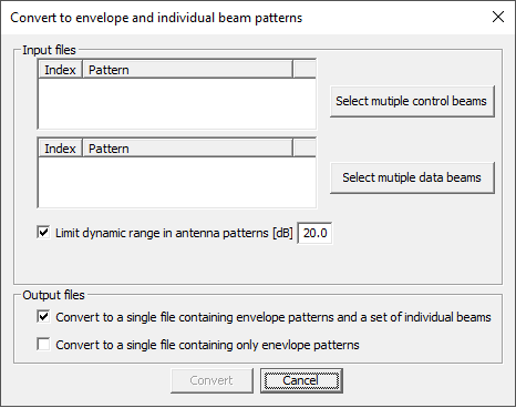

- Convert to beams and envelope patterns
is useful when the antenna patterns of the individual beams are available in individual antenna-pattern files, for example, from a simulation or a measurement. The Convert to envelope and individual beam patterns dialog enables you to select the files that contain the patterns of the control beams and data beams. The contents of the files are combined into larger files with the appropriate formats.

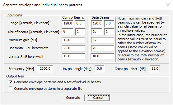

Figure 3. The Convert to envelope and individual beam patterns dialog. - Generate beams and envelope patterns
is useful when the patterns of individual beams are not readily available. The Generate envelope and individual beam patterns dialog requires input data as shown in Figure 4.

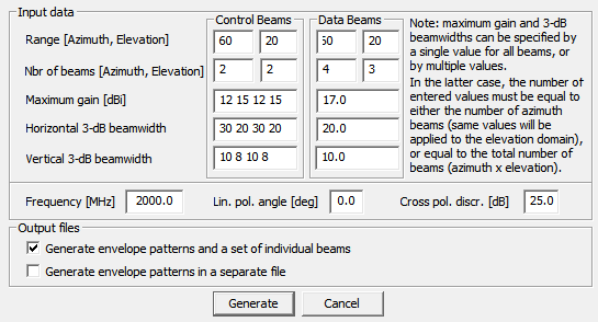

Figure 4. The Generate envelope and individual beam patterns dialog.User-defined beams can be specified using the following options (applicable to both Control Beams and Data Beams):- In the fields for gain and beamwidth, specify a
single value per field which will be applied to all
beams.

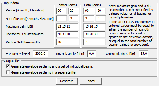

Figure 5. Example 1: for the Control Beams, a single value is applied to both the azimuth and elevation beams (similar for Data Beams). - Specify multiple values in the azimuth domain.Note:
- The number of values for gain and horizontal beamwidth must equal the number of azimuth beams.
- The same values are applied to the elevation domain.
Figure 6. Example 2: for the Control Beams and Data Beams, three values are entered for the gains and three for the horizontal beamwidths. These govern the horizontal distributions. - Specify multiple values in the azimuth and elevation domain.Note:
