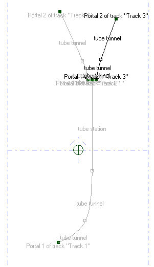

TuMan
Figure 1. Top view of the tunnel in TuMan.
Track startpoints and endpoints are denoted “portals”. A track is a tunnel which does not need to have a constant cross-section. Cross-sections are defined in separate windows in TuMan and are assigned to segments of the tracks. This example has two cross-sections, denoted “tube tunnel” and “tube station”. The tube station is wide enough to connect to two tube tunnels.
At the end of the TuMan session, a database is exported for use in WallMan.

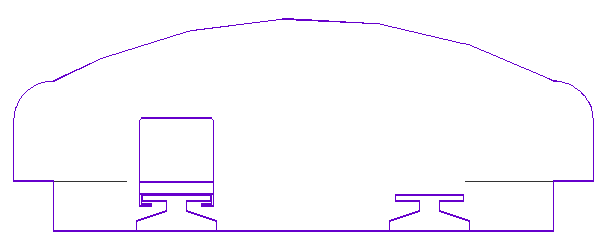

Figure 2. A cross-section view of the tunnel geometry with an added train and elevated railway tracks.

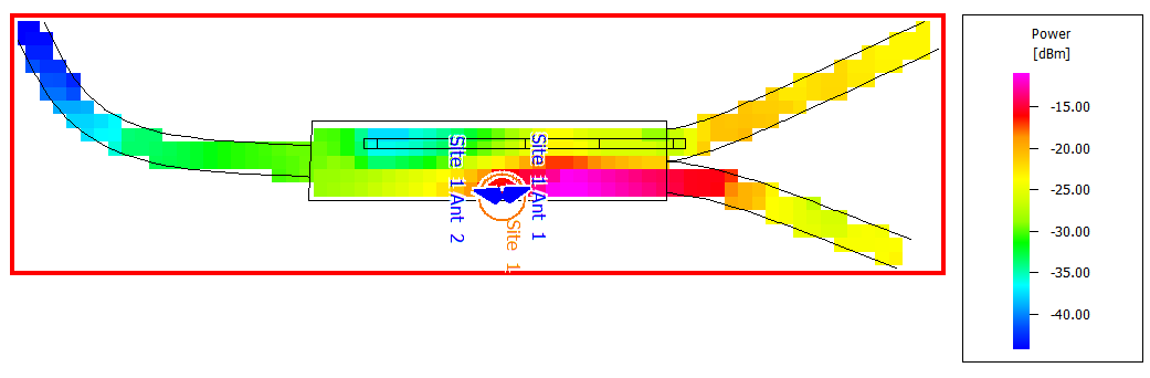

- Results
Propagation results show at every location the power received from each individual transmitter antenna. Figure 4 shows the results for Site 1 Antenna 1 at a height of 4 m (a predefined height).
Figure 4. Power received by a hypothetical isotropic antenna when antenna 1 is transmitting.Propagation results were calculated for field strength, path loss, delay spread, and angular spreads.
