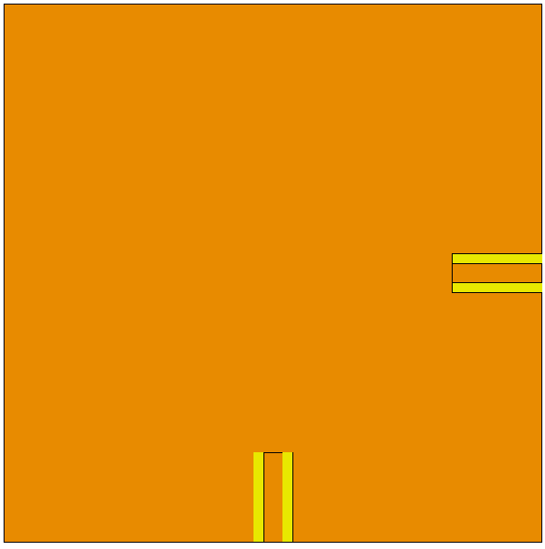

Create the inset feeds.
Create a rectangle.
- Definition method: Base corner, width, depth
- Base centre (C): (-1.4e-3, -39e-3/2, 0)
- Width (W): 2.8e-3
- Depth (D): 6.5e-3
- Label: InsetRectangleLarge
Create another rectangle.
- Base centre (C): (-1.4e-3/2, -39e-3/2, 0)
- Width (W): 1.4e-3
- Depth (D): 6.5e-3
- Label: InsetRectangleSmall
- Union InsetRectangleSmall with InsetRectangleLarge.
- Copy and rotate the Union by 90 degrees.
- Union all the parts in the tree.
- Delete the two face pairs from the newly created Union1 to complete the inset feeds.
Figure 1. Construction of the inset feeds for the patch (redundant faces to be deleted in yellow.) -

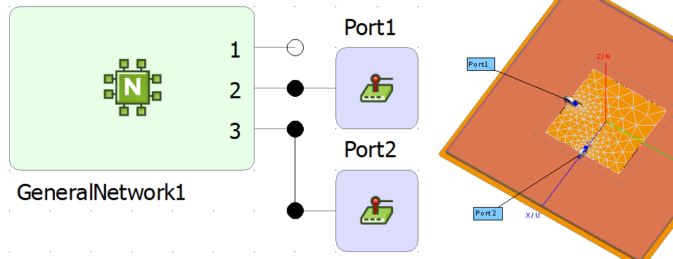

Create a rectangle.
- Create two microstrip ports on the outer edges of the inset feeds, one port for each feed.
Create a new network.
- Data type: S-matrix
- Source: Touchstone file
- Number of network terminals: 3
- Browse for the .s3p file.
- Connect the input ports of the patch to the output ports of the network in the schematic view.
Figure 2. Schematic view showing the port connections.
Add a voltage source to GeneralNetwork1.Port1
Note: The voltage source will not be displayed in the schematic view.
