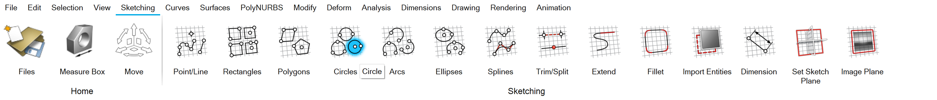

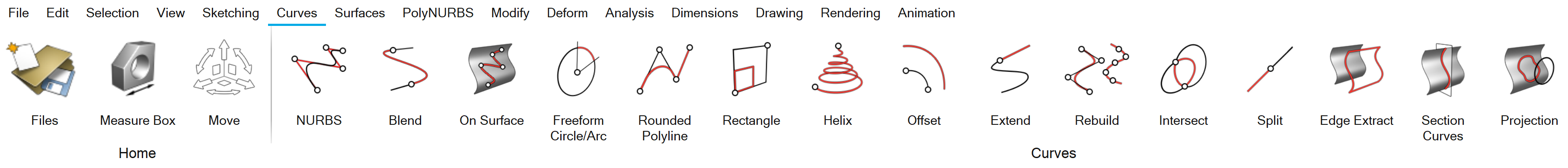

  2. The ribbon across the top of the application displays all of the tools available in Inspire Render. Click on the tabs at the top of the ribbon to switch between the various menus and ribbons. The name of the active ribbon has a blue underline.
  3. Some icons in ribbons such as Sketching provide access to one or more tools. As you mouse over an icon, the individual tools glow with a blue border.

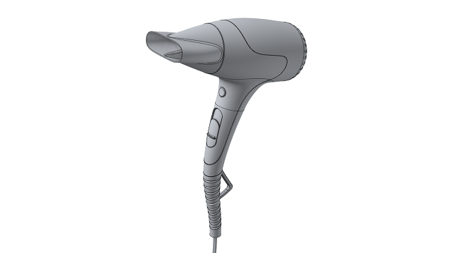

Open the Hair Dryer Model
  1. Click Open Model on the Files icon.
  2. In the Open File window, browse to the scenes folder in the installation directory.
    Note: For most users, the installation directory will be located here:
    C:\Program Files\Altair2021.0.1.XXXXX\InspireStudio2021.0.1.XXXXXDev\Evolve\Assets\Examples\Scenes
  3. Select the Hair dryer.iStudio file from the scenes directory.
  4. Click Open.

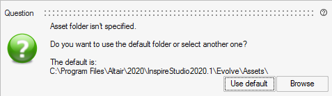

Set the Assets Folder From the Prompt
If the path to the assets is not set or is set incorrectly, you may see the following prompt on first launch of Inspire Render.
You should select Use default. If you would like to use assets from older versions of Inspire Render, follow the steps below.

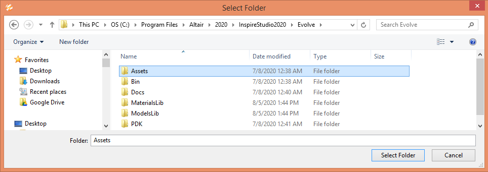

  1. Click Browse.
  2. Browse to an older installation of the application under C:\Program Files\Altair\.
  3. Select an installation that contains the assets folder.
    For example: C:\Program Files\Altair\2021.0.1\InspireStudio2021.0.1\Evolve\Assets
  4. Select the Assets folder.
  5. Click Select Folder.
