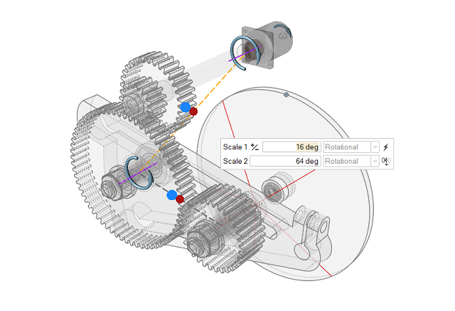

Add Couplers to the Model
Select the Couplers tool from the Connections
group.
- Select At Free Joints on the guide bar.
Click the
button on the guide bar.
Two joint couplers are created.
In the microdialog, note the scale factors. The software extracted the ratio
automatically from the number of teeth on the gears. This feature is only
available when you use the At Free Joints option on the guide bar.
Select the other coupler with the 32:64 gear ratio in the modeling window or
Model Browser and note the scale factors.

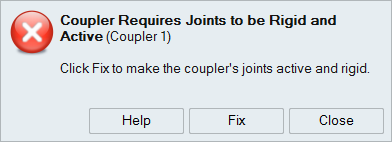

Run a Second Motion Analysis with the Joint Couplers
Click the Quick Run button on the Analyze Motion
tool.
A warning message is displayed, noting that couplers require joints to be rigid and active.
Click the Fix button to make the couplers' joints rigid
and active.
Note: To avoid getting this error message, click the
icon on the Couplers guide bar and select Force coupled joints
to be rigid. -

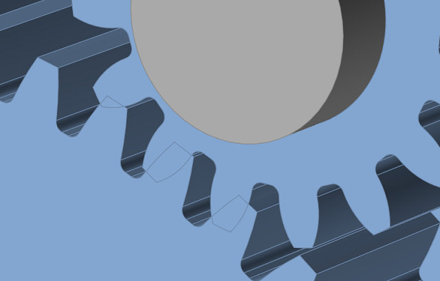

Animate the model and observe that the gear teeth on the Tumbler Gear and the
64t Gear 3/8" are passing through each other, which is incorrect. We will fix
this by reversing the direction of the joint coupler.

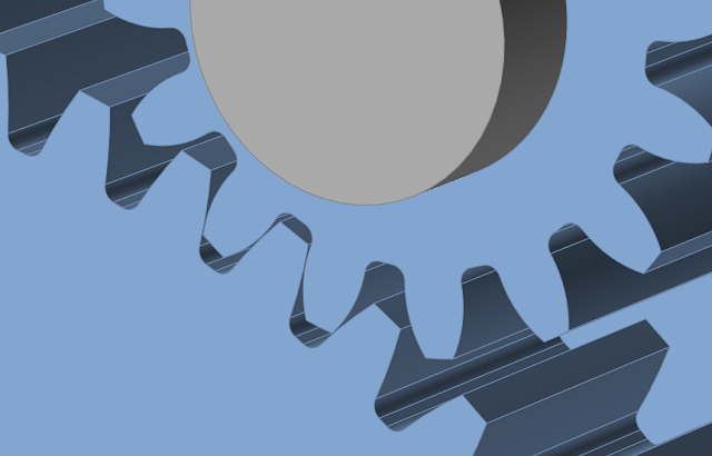

Reverse the Direction of Joint Coupler Motion
Select the Couplers tool.
Select the coupler that joins the Tumbler Gear and the 64t Gear 3/8" in the
modeling window or Model Browser.
The couplers are represented by pairs of blue and red circles.
On the microdialog, click the
icon to reverse
the direction of joint coupler motion.
Run a Third Motion Analysis and Plot the Results
Click the Quick Run button on the Analyze Motion tool to
see the model in motion, and let it run to completion.
Now the gear teeth are meshing as intended.

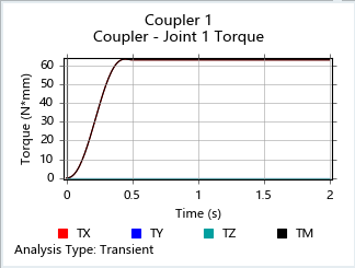

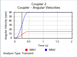

Select Coupler 1 in the Model Browser to plot the
results.
By default, the plot shows the torque in one of the coupled joints. Next we will compare the rotational speed of both joints used in the coupler.

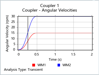

Right-click on the plot and select Angular Velocities
from the context menu.
From this plot, you can see the speed ratio is 2:1.
Select Coupler 2 in the Model Browser.
Now we see the ratio for Coupler 2, which is 4:1.

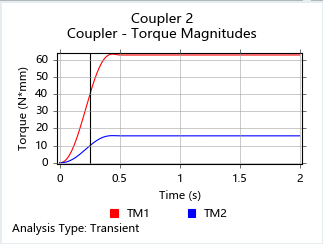

Right-click on the plot and select Torque
Magnitudes.
Torque magnitudes also exhibit the coupler ratio.
