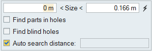

Find Options
Click the
menu on
the guide bar to filter the results of the find operation.
- Find Larger/Smaller/Similar
- Find holes that are smaller, larger, or similar (±5%) in size to selected holes.
- Options
- Click to specify options for the find operation.
- Size
- Specify a minimum and maximum size range for the hole diameter. This option applies to
Aligned Holes and Single Holes. Click the
icon to
reset the default value. - Find Parts in Holes
- If enabled, the Joints tool automatically finds existing geometry in holes, hides it, and deactivates it so that it is not included in analysis or optimization calculations. Deselect Find Parts in Holes to disable this behavior, in which case you will need to delete the existing geometry manually.
- Find Blind Holes
- Enable to automatically detect blind holes during the find operation.
- Auto Search Distance
- This is a global search threshold that uses default tolerances to find locations where joints can be created. When the checkbox is enabled, it is calculated automatically. To change the search distance, deselect the checkbox and enter a value in the text box. Any joints with a minimum gap less than the entered search distance will be found. (The minimum gap is the exact minimum distance between the two parts.)

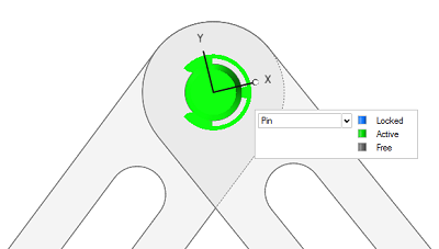

Microdialog Options
Use the options in the microdialog to change the joint type and how it is constrained.
Figure 1. Joints Microdialog
- Joint Type
- Joints are available in a variety of types such as Pin, Hinge, or Ball and Socket. The types available vary based on the feature where the joint is being applied.
- Joint State
- Each joint has a state which can be set to Locked, Active, or Free.
- Select Locked to prevent movement in the joint.
- Select Free if you want the mechanism to behave as if the joint is not there.

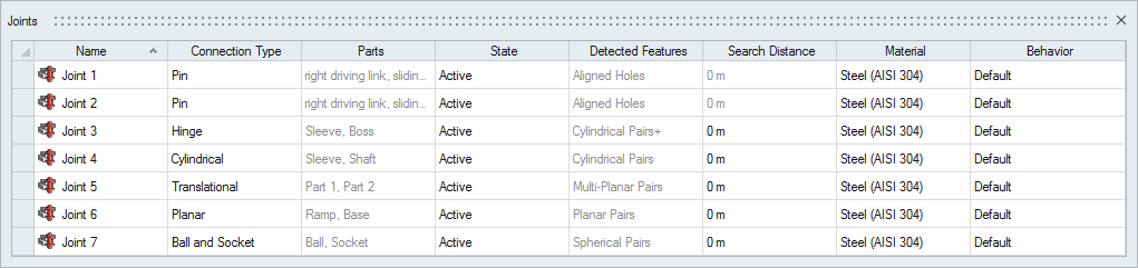

Joints Table
The Joints table lists all of the joints in your model including the type of connection, the parts it connects, and the assigned material.
Click the
satellite icon on the Joints tool to display the table.
Figure 3. Joints Table
The table data can be edited with the following actions:
| To | Do this |
| Rename a joint | Select the cell in the table and then click again to make the field editable. |
| Change the connection type, state, material, or behavior | Select the cell in the table and then select a different option from the list. |
| Sort a column | Click the column header. Click repeatedly to toggle between ascending and descending order. |
| Add or remove columns | Right-click on a column header. |
