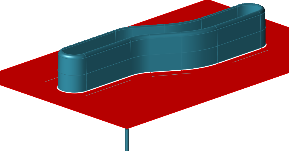

Set Up the Single Action Draw Operation

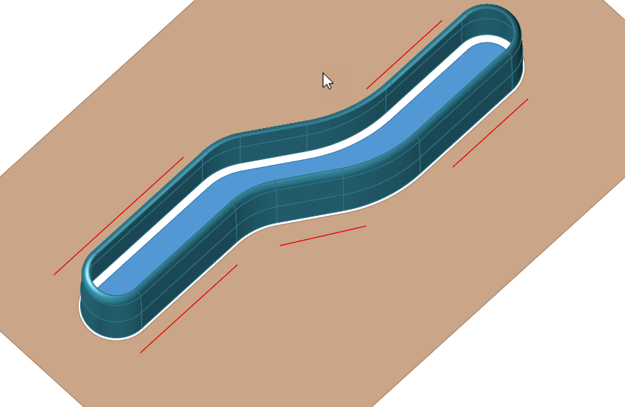

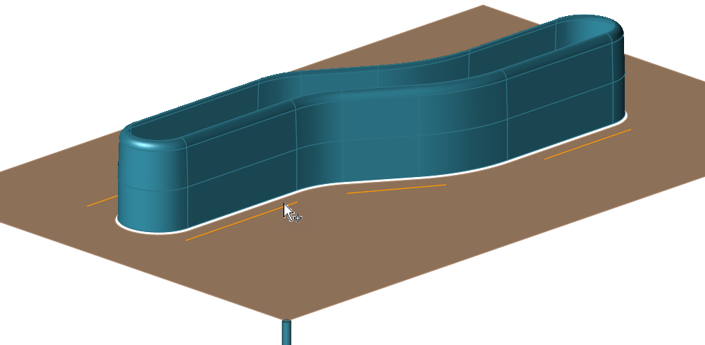

Add Tools to the Single Action Draw Operation
Configure the Top Pad
Configure the Drawbead

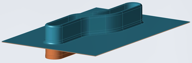

Position the Die in the Forming Operation
lets you preview the die set between the open and closed
states. The position of the die set can be defined automatically or manually.

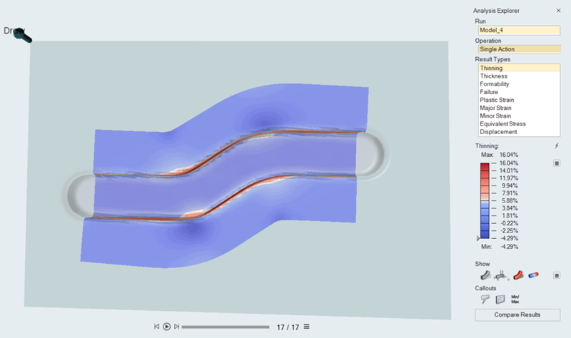

Review the Simulation Results
The Analysis Explorer lets you choose a variety of results to review. An animation for each result type is included. By default, the results for thinning are displayed on the formed part.
View the animation of the forming results by adjusting the slider that is
located at the bottom of the modeling window:
- To see what areas on your model are under the greatest thinning, click
and move the slider.
- To view the animation of the results, click the play button:
- To adjust the animation settings, click the edit button:
From the Animations Settings dialog, choose options for playback and display. To adjust the animation speed, move the slider to the right to increase or left to decrease the speed.
- To view additional results, from the Analysis Exporer, select a Run, Operation, and Result Type.
