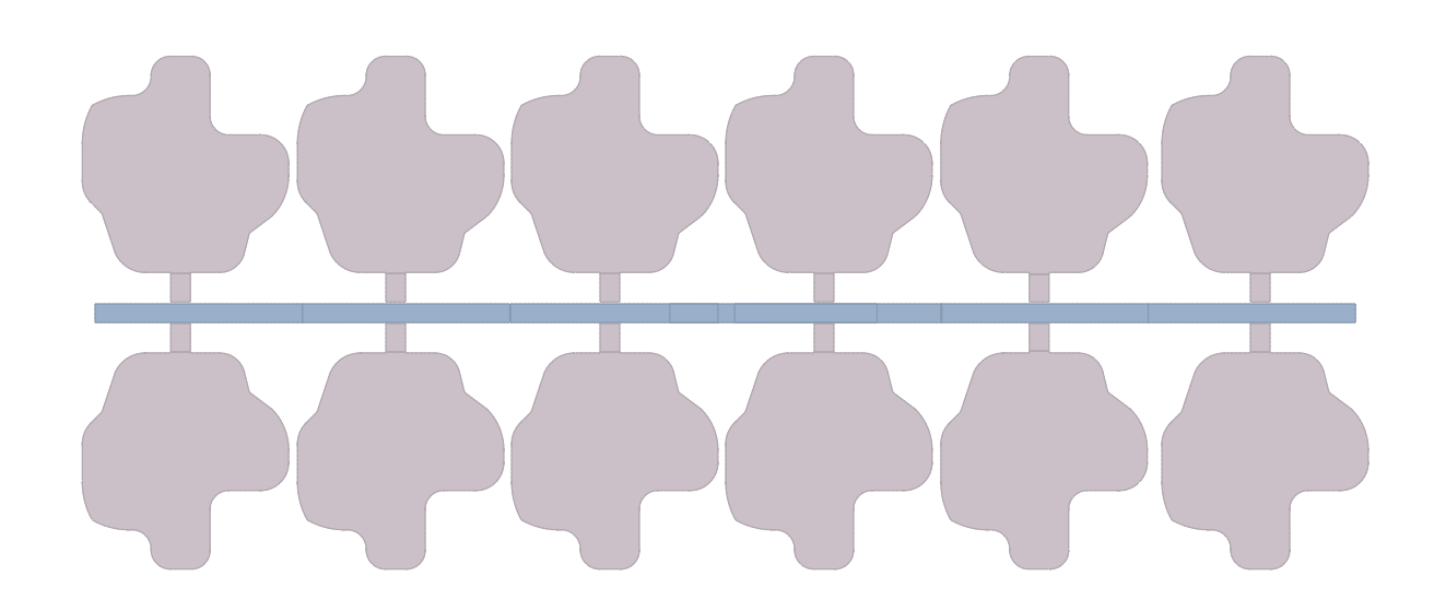

| Central | The carrier is in the center with the parts attached on both
sides. The parts mostly will be reflection of each other. ![]() |
| Double-sided and central | The carrier is in the center with the parts attached on both
sides. The parts mostly will be reflection of each other. There is
also a carrier on both ends. ![]() |

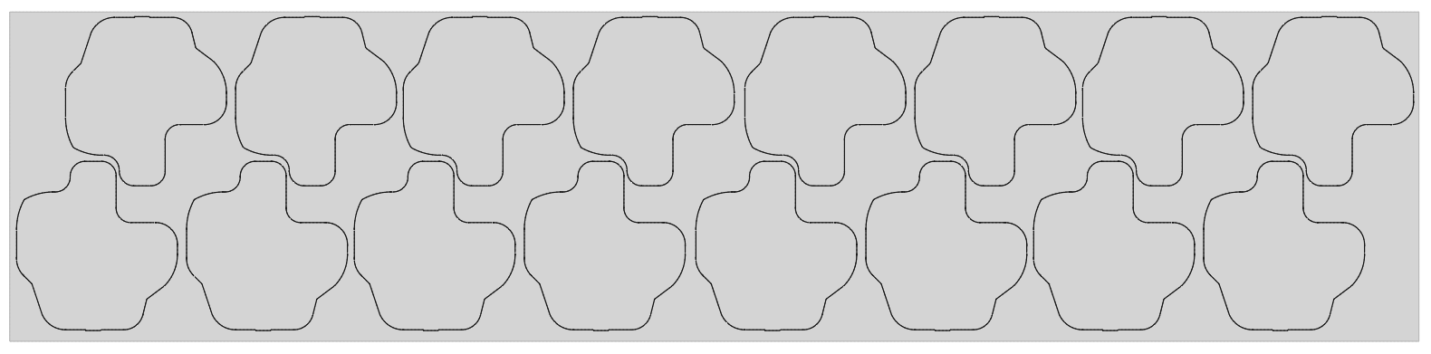

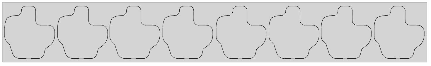

| One-up | This option allows you to nest one instance of the part on coil or sheet metal so that every stroke of press will produce a single part. ![]() |
| Two-up | This option allows you to nest two instances of the part on a coil or sheet metal so that every stroke of press will produce two identical parts. ![]() |
| Mirror | This option allows you to nest one instance of the part and its mirror image on the coil or sheet metal so that every stroke of press will produce two parts that are mirror images of each other. ![]() |

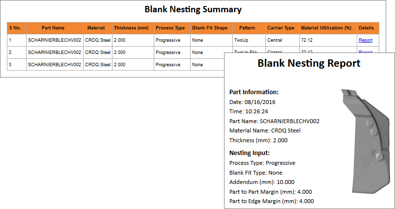

View Blank Nesting Summary
View the summary of a blank nesting.

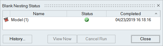

Blank Nesting Status
View the status of the current run, as well runs for the current model that have not yet been viewed. To see all past runs, you need to view the run history.

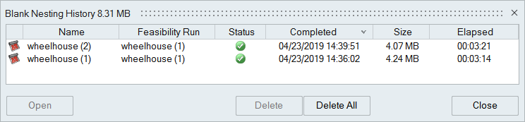

Blank Nesting History
View, sort, open, and delete past runs for the current and previous models.
