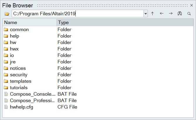

The File Browser allows for browsing folder contents, adding new
files, and deleting existing ones.
Files can be opened in the Editor by right-clicking on it and selecting
Open. The displayed list can also be filtered by file types and/or
matching patterns. These options are accessible by right-clicking on the File Browser. Figure 1.
