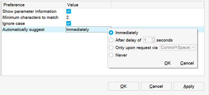

The options to trigger completions can be defined in the Preferences dialog. Figure 6.
