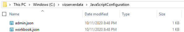

Starting with version 2020.1, Panopticon Visualization server generates JSON configuration files in the JavaScriptConfiguration directory of the AppData folder (i.e., c:\vizserverdata).

NOTE |
· With the new application configuration files, the workbook/config.js inside the extracted war file is no longer valid. · If there are no config files available on the server, default ones will be created and saved. After that, you can alter them in any way you would like and keep the configuration even if the server is restarted.
