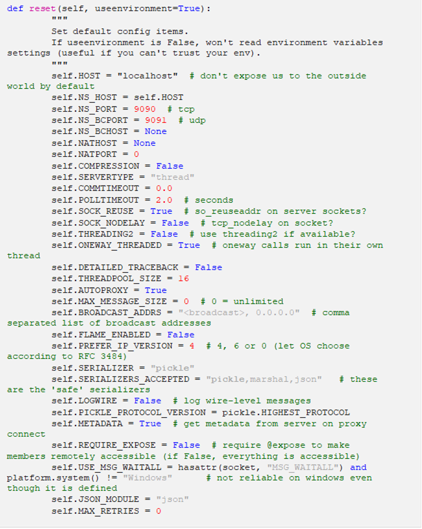

To enable the Pickle serialization, modify the configuration.py file located in ..\Anaconda3\Lib\site-packages\Pyro4 to specify the serialization to be used.
For example, if Pickle is selected, self.SERIALIZER value should be changed to pickle and self.SERIALIZERS_ACCEPTED value should be changed to include pickle:
def reset(self, useenvironment=True): """ Set default config items. If useenvironment is False, won't read environment variables settings (useful if you can't trust your env). """ self.HOST = "localhost" # don't expose us to the outside world by default self.NS_HOST = self.HOST self.NS_PORT = 9090 # tcp self.NS_BCPORT = 9091 # udp self.NS_BCHOST = None self.NATHOST = None self.NATPORT = 0 self.COMPRESSION = False self.SERVERTYPE = "thread" self.COMMTIMEOUT = 0.0 self.POLLTIMEOUT = 2.0 # seconds self.SOCK_REUSE = True # so_reuseaddr on server sockets? self.SOCK_NODELAY = False # tcp_nodelay on socket? self.THREADING2 = False # use threading2 if available? self.ONEWAY_THREADED = True # oneway calls run in their own thread self.DETAILED_TRACEBACK = False self.THREADPOOL_SIZE = 16 self.AUTOPROXY = True self.MAX_MESSAGE_SIZE = 0 # 0 = unlimited self.BROADCAST_ADDRS = "<broadcast>, 0.0.0.0" # comma separated list of broadcast addresses self.FLAME_ENABLED = False self.PREFER_IP_VERSION = 4 # 4, 6 or 0 (let OS choose according to RFC 3484) self.SERIALIZER = "pickle" self.SERIALIZERS_ACCEPTED = "pickle,marshal,json" # these are the 'safe' serializers self.LOGWIRE = False # log wire-level messages self.PICKLE_PROTOCOL_VERSION = pickle.HIGHEST_PROTOCOL self.METADATA = True # get metadata from server on proxy connect self.REQUIRE_EXPOSE = False # require @expose to make members remotely accessible (if False, everything is accessible) self.USE_MSG_WAITALL = hasattr(socket, "MSG_WAITALL") and platform.system() != "Windows" # not reliable on windows even though it is defined self.JSON_MODULE = "json" self.MAX_RETRIES = 0
