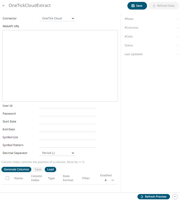

1. On the New Data Extract page, select OneTick Cloud in the Connector drop-down list.

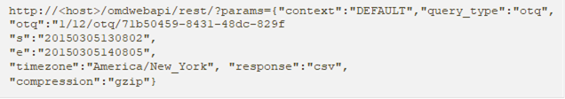

2. Enter the OneTick Cloud WebAPI URL into the WebAPI URL box with the following form:
Where:
· s, e, timezone – the start and end time of the query YYYYMMDDhhmmss form. The timezone used to interpret this value is taken from the timezone parameter.
· response – the supported response format is csv.
· compression – if available, this option enables gzip compression of the results stream. Large data should always be pulled with compression on.
3. Enter the User Id (email) and Password to execute the query and retrieve the data. Note that the User Id is case sensitive.
4. Enter the time window Start Date and End Date.
5. Enter the Symbol List. This value filters the query output with matching symbols.
To make it work, ensure to include Symbol in the Query URL. Consequently, the data will be filtered out for the input (Symbols) provided in the Symbol List field.
6. Enter the Symbol Pattern. This value filters the query output with the data for all the symbols with matching pattern.
To make it work, ensure to include Symbol_Pattern in the Query URL. Consequently, the data will be filtered (for all the Symbols) with matching pattern provided in the Symbol Pattern field.
7. Select either the dot (.) or comma (,) as the Decimal Separator.
8. Click
to
the fetch the schema based on the connection details. Consequently,
the list of columns with the data type found from inspecting the first
‘n’ rows of the input data source is populated and the Save
button is enabled.
9. You can also opt to load or save a copy of the column definition.
