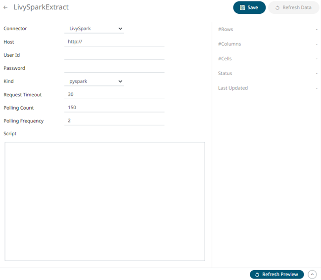

1.     On the New Data Extract page, select LivySpark in the Connector drop-down list.
2.     Enter or select the following properties:
Property
Host
Livy Spark host address.
User Id
User Id that will be used to connect to Livy Spark.
Password
Password that will be used to connect to Livy Spark.
Kind
Currently, the supported kind of connection to be used is pyspark (Interactive Python Spark session).
Request Timeout
Length of time to wait for the server response. Default is 30.
Polling Count
The number of polling done to the Livy Spark server to check if the status of the app is successful. Default limit is 150.
Polling Frequency (in seconds)
Frequency of the polling. Default is 2.
Script
The script to use.
3.     Click    to save and display the details of the data extract.
4.     Click   then   to display the data preview.
