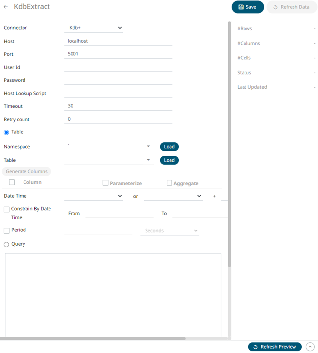

1.     On the New Data Extract page, select Kdb+ in the Connector drop-down list.
2.     Enter the following properties:
Property
Host
Kx kdb+ host address.
Port
Kx kdb+ host port. Default is 5001.
User Id
The user Id that will be used to connect to Kx kdb+.
Password
The password that will be used to connect to Kx kdb+.

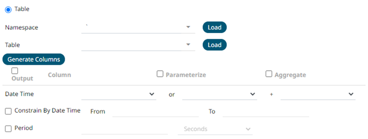

3.     When Table is selected, the section below is enabled:
The Namespace drop-down is an editable combo box.
You can either:
·         click  and select a namespace from the list of all root level namespaces. By default, the selected namespace will be root (backtick `).
·         For nested namespaces, enter them in the Namespace box (e.g., panopticon.test) to get the tables that were created under these namespaces.
4.     On the Table field, click  to populate the drop-down list with tables and views. Select a table or view.
5.     Click . The columns of the selected table or view populates the Output Column section.
6.     Individual columns can be added by checking the corresponding Column box in the Output Column listing.

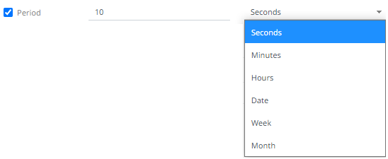

11.   In Kx kdb+, you can modify the query to regroup the aggregated data per time units (i.e., Seconds, Minutes, Hours, Date, Week, Month). Check the Period box, enter the time duration and click  then select the time unit.
