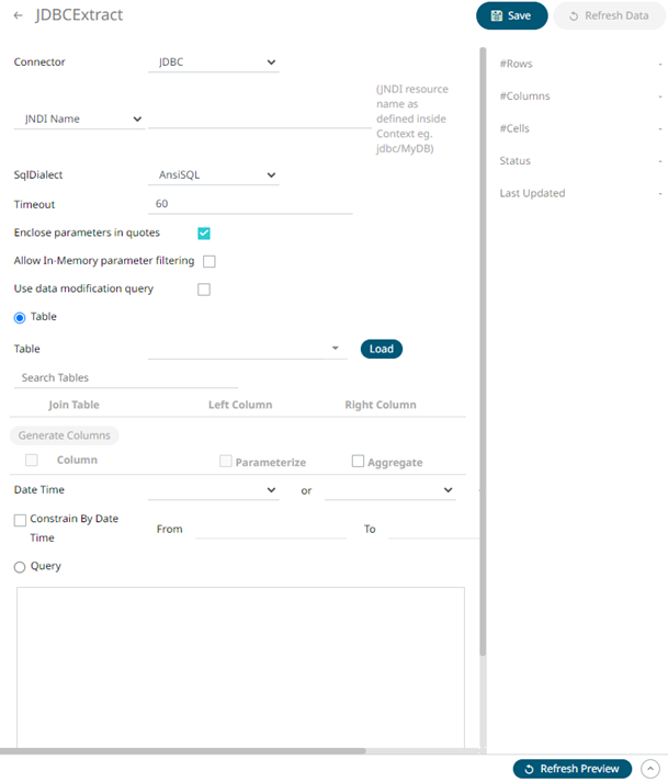

1.     On the New Data Extract page, select JDBC in the Connector drop-down list.
2.     You can either select:
·         JNDI Name

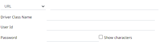

·         URL
Enter the URL specific to the database’s JDBC driver, the Driver Class Name specific to the driver, and the Username and Password.
Check the Show Characters box to display the entered characters.

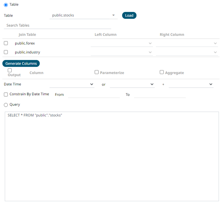

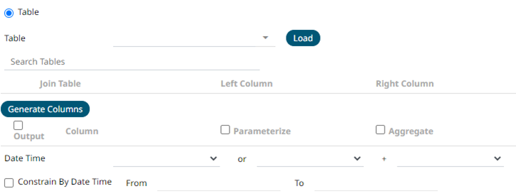

6.     When Table is selected, the section below is enabled:
7.     On the Table field, click  to populate the drop-down list with tables. Select a table.

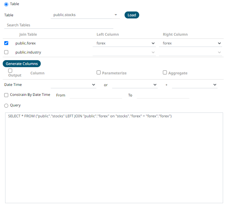

The list of tables that you can join is displayed. Also, the SQL query is generated and displayed in the Query text box.
Use Search Tables to filter the list.

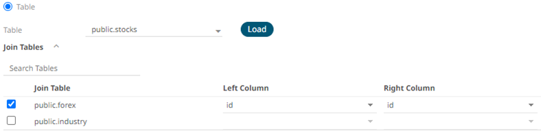

8.     Perform a join by checking one or more tables in the list.
The Left Column and Right Column fields are automatically filled out with the common fields.
You can also opt to select other common fields.
The SQL query is generated and displayed in the Query text box.
