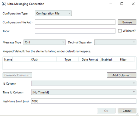

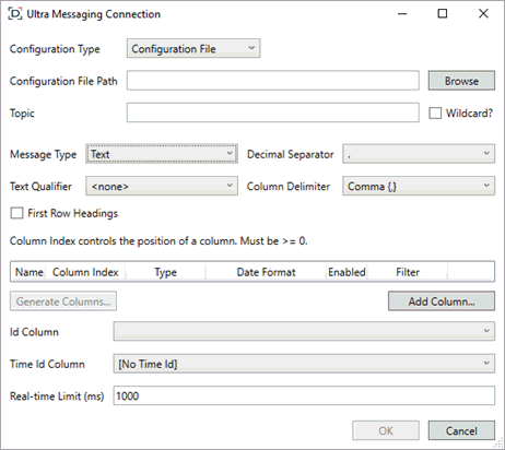

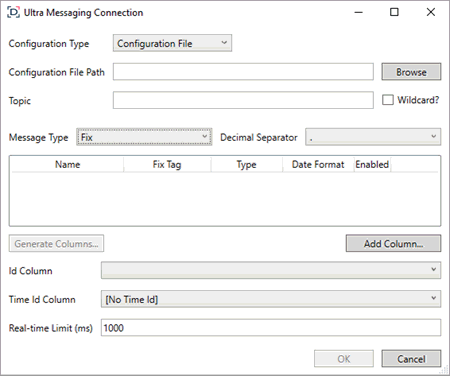

When creating a new data table, select Ultra Messaging Streams from the Connect to Data dialog. The Ultra Messaging Connection dialog is displayed.
Select Configuration File in the Configuration Type drop-down list.
Browse to the Configuration File source.
For the Topic section, can either:
just enter the Topic name if you are using the Specific Topic type, or
enter the Topic pattern if you are using the Perl-compatible Regular Expression (regex) Topic type then check the Wildcard box.

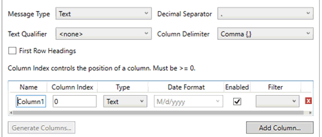

The dialog slightly changes to allow specification of the following:
Text Qualifier
This drop-down list box specifies if fields are enclosed by text qualifiers, and if present to ignore any column delimiters within these text qualifiers.
Column Delimiter
This drop-down list box specifies the column delimiter to be used when parsing the text file.
First Row Headings
This checkbox determines if the first row should specify the retrieved column heading, and not to be used in data discovery.
Select the Decimal Separator. This specifies the character for decimal separation, when parsing a numeric value. By default this is “.”

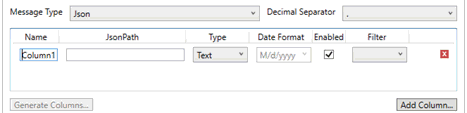

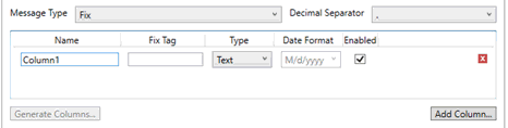

Click Add Column.
Enter or select:
Name
XPath/JsonPath/Fix Tag/Text Column Index (for example, price/@stock)
Type (Numeric, Text or Date/Time)
Date/Time format when the Data Type is Time

Enabled (whether the message field should be processed)
Filter (Defined parameters that can be used as Filter)

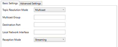

The dialog changes to display two tabs:
Basic Settings
For the Topic Resolution, you can either select:
Multicast
Enter the IP address for the Multicast Group.
Enter the Destination Port (a numeric value between 1 and 65535).
Unicast
Click Add then enter the Resolver Daemon IP Address and the Port. You can also select an added IP Address and click Remove to delete it in the list.
Enter the IP address or CIDR notation pattern matching network interface on the host on which the connector is running in the Local Network Interface box.
Select the Reception Mode: Streaming, Persistent and then enter the Persistent Session ID, or Ultra Load Balancing and then enter the ULB Receiver Type ID.

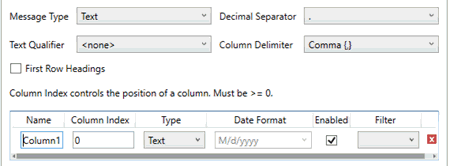

Text Qualifier
Column Delimiter
First Row Headings
Click Add Column.
