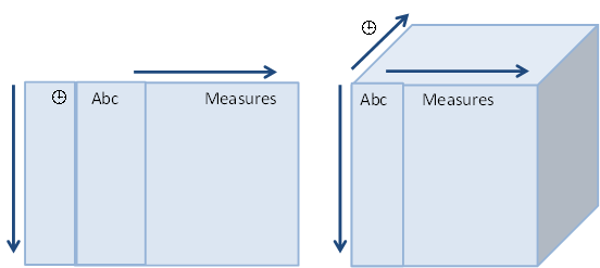

Your source data must be transformed in order to use Time Series visualization. The transform converts the dataset into a cube, where the Z axis of the cube represents time, providing a set of time slices to play through and calculate across.

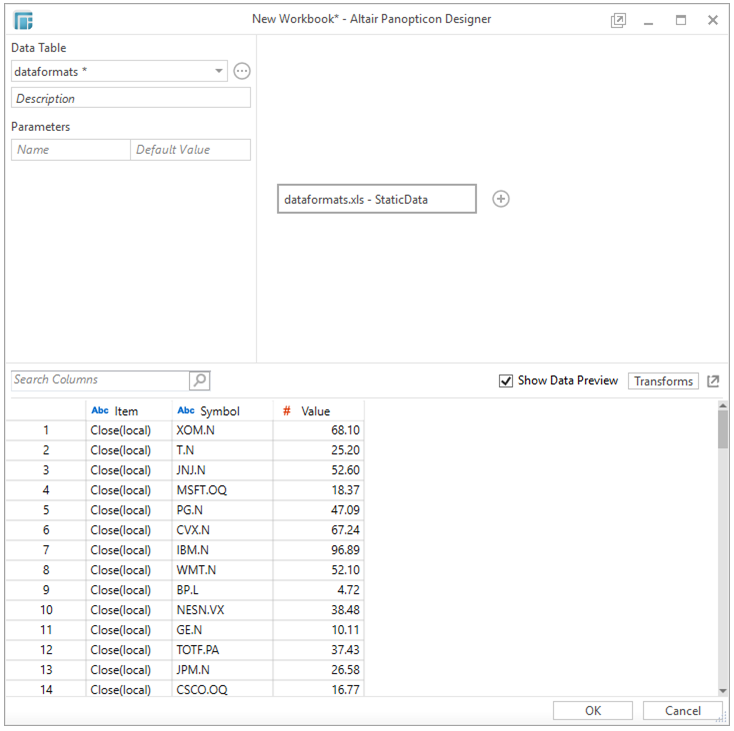

Select the Data Table you want to use for a time series display and click Transforms in the Data Preview area:

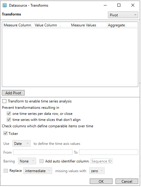

The Datasource - Transforms dialog displays.
Check Transform to enable Time Series analysis box.
The check boxes for: one time series per data row, or close and time series with time slices that don’t align, ensure that duplicate value are highlighted, and the time cube volume is minimized.
Select the key or compound key columns from the source list of dimensions to define comparable items over time.
These define each series, and correspond to the rows of the generated time cube.
Select the column to define the time axis values (Date/Time stamp).
Set the Date/Time range of the column set in step 4 in the From and To text boxes.
This filters the time series visualization data causing less data to go over the network to the Web Client.
NOTE: The range is not calculated from the start and end values but rather from the Max (the start or the first time slice of the dataset) to Min (the end or the last time slice of the dataset) range. For example, the start and end values can be from 2000-01-01 to 2020-01-01 but the conflation still works as it takes the Date/Time range of the supplied time series.

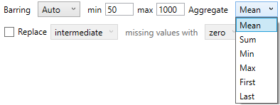

Choose whether you want to conflate the dataset by setting the Barring period to Auto, or a defined value, between Year and Nanosecond.
Setting the barring period conflates the dataset to a defined granularity, returning a set number of data points, by default being between 50 and 1000 for Auto.
As data is potentially being aggregated across time, an Aggregate must be selected. The default conflation aggregate is Mean. Other options include: Sum, Min, Max, First, and Last.

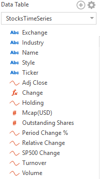

Once saved, a time series data table is visually identified by the time series curve to the left of any numeric time series fields.
