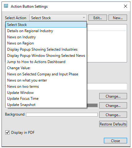

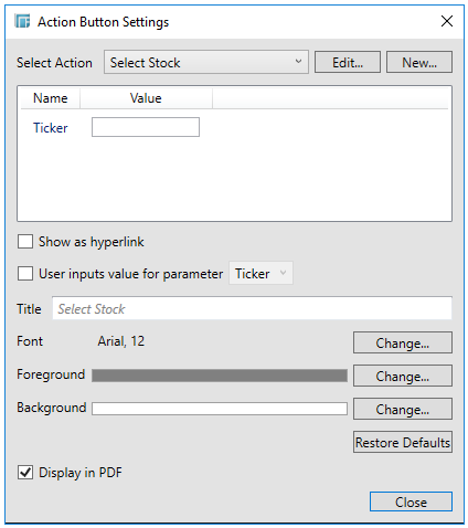

Select the newly added button and click the Settings icon.
The Button Settings dialog is displayed.
Select an action to be used by the button.
Define any parameter values that the action requires.
The Title of the action button defaults to the selected action name.

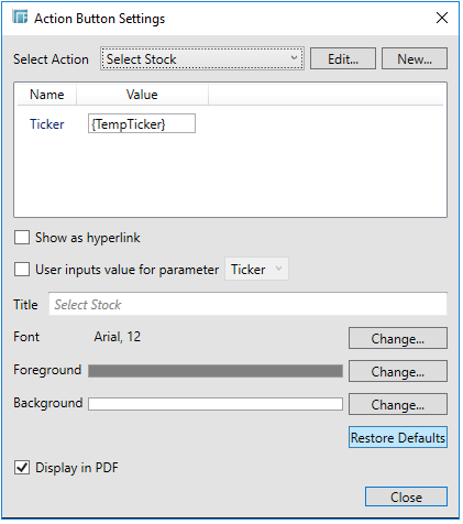

NOTE: These values can also be other parameters. This allows parameter values to be set, and then separately executed upon using the action button.

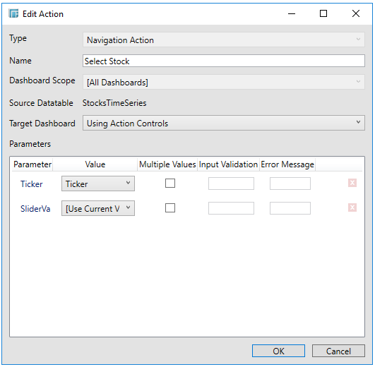

You can also modify the parameter values of the selected action by clicking Edit.
The Edit Action dialog displays.
If you selected an interactive parameter (i.e., $Interactive), the Input Validation and Error Message boxes are enabled.

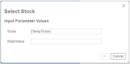

When an action is executed which require an interactive parameter, an associated dialog box will be displayed.
For example:

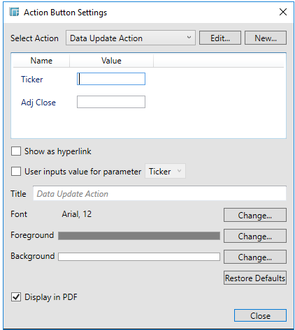

Sample 1:
Both the Ticker (interactive) and Adj Close (use current value) columns have no set values and will be shown in Web client as:

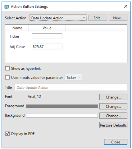

Sample 2:
Both the Ticker (interactive) and Adj Close (use current value) columns will be displayed in the Interactive Parameters dialog, along with the value of Adj Close:

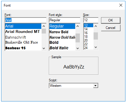

Font - Click Change to display the Font dialog where you can set the Font Type, Style, Size, and Script.
