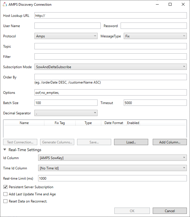

When creating a new data table, select AMPS Discovery from the Connect to Data dialog.
The AMPS Discovery Connection dialog is displayed.
Enter the Host Lookup URL.
Enter the Username and Password to pass to the Host Lookup URL as basic authentication.
Select the Protocol. This will specify the format of the headers:
Amps (default)
Fix
NvFix
XML
Select the Message Type. This will specify the format of the data within the message:
Fix (default)
XML
NvFix
JSON
NOTE: Starting with AMPS 4.0, different formats for the protocol and message type can be specified. It is highly recommended to use the amps protocol for new applications, and a protocol that matches the message type (fix, nvfix, xml) for older ones.
Select from any of the following Subscription Modes:
Sow
SowAndSubscribe
SowAndDeltaSubscribe (default)
Subscribe
DeltaSubcribe
Enter the Order By Statement in order to limit the returned data. For example:
/orderDate DESC
/customerName ASC
Enter any of the following Options for the selected Subscription Mode:
cancel
live
no_empties
null
no_sowkey
oof
pause
replace
resume
send_keys
timestamp
NOTE: Leave the Options box blank if you selected the Subscribe subscription mode.
Enter the Batch Size. This is the number of messages that will be sent at a time as results are returned. Default is 100.
Enter the Timeout for the length of time to wait for the server response. Default is 5000.
Select either the dot (.) or comma (,) as the decimal separator.
After entering the valid connection settings, click the Test Connection button. A confirmation dialog displays to show that the connection was successfully established.

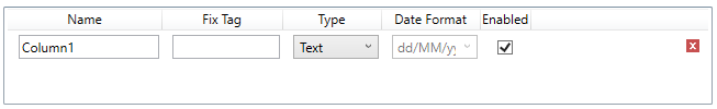

Click Add Column. This adds columns to the AMPS connection that will represent sections of the message.
Provide the following information:
Name
Fix Tag
Type (Numeric, Text, and Date/Time)
Date/Time Format when the Data Type is Time
Check the Enabled box to process the message field
If Message Type is set to Fix or NvFix, the Add Column will display as:

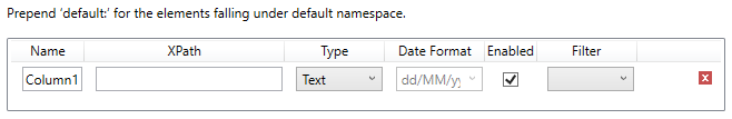

If Message Type is set to XML, the Add Column will display as:

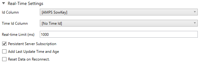

Expand Real-Time Settings.
NOTE: The default Id Column for the AMPS connector is AMPS SowKey which is used by AMPS to identify a message by this unique key.
Refer to Defining Real-Time Settings for more information.
