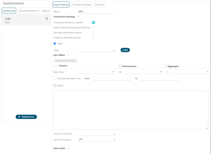

1.     Select JDBC from the Data Sources pane. The JDBC Settings pane and the retrieved JDBC source are displayed.
2.     Enter the Name of the JDBC data source, then click .
3.     Click Connection Settings to expand and display the properties you can set.

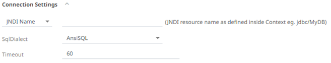

4.     You can either select:
·         JNDI Name
Enter the JNDI resource name to be used.
   NOTE
The JNDI resource name needs to be on the form:
jdbc/[resourcename]

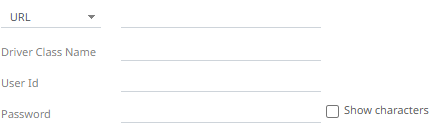

·         URL
Enter the URL specific to the database’s JDBC driver, the Driver Class Name specific to the driver, and the User Id and Password.
Check the Show Characters box to display the entered characters.

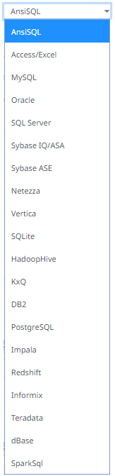

5.     Select the appropriate SQL Dialect in the drop-down list to be able to generate the correct SQL for the required data repository.
You can select any of the following SQL dialects: AnsiSQL, Access/Excel, MySQL, Oracle, SQL Server, Sybase IQ/ASA, Sybase ASE, Netezza, Vertica, SQLite, HadoopHive, KxQ, DB2, PostgreSQL, Impala, Redshift, Informix, Teradata, dBase, SparkSQL.
Default is AnsiSQL.
6.     Enter the Timeout. Default is 60.

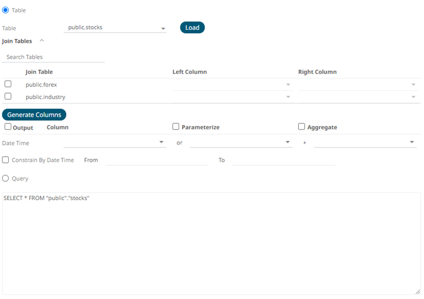

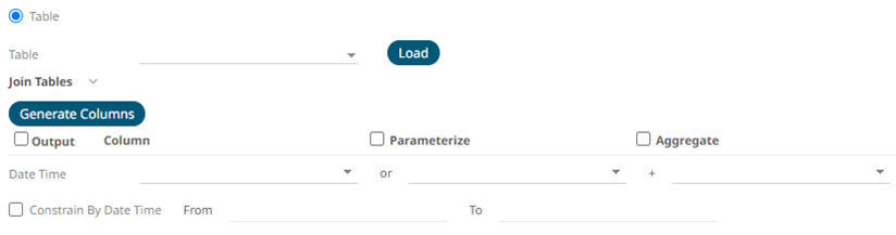

8.     When Table is selected, the section below is enabled:
9.     On the Table field, click  to populate the drop-down list with tables. Select a table.
The SQL query is generated and displayed in the Query text box.

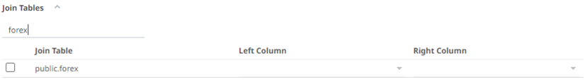

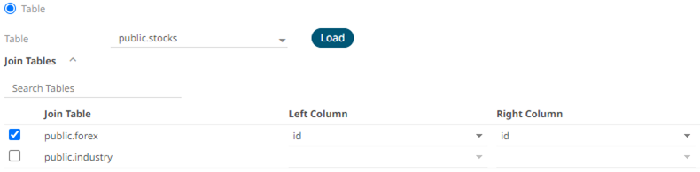

Also, expanding the Join Tables displays the list of tables that you can join.
Use Search Tables to filter the list.

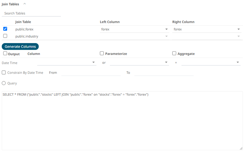

10.   Perform a join by checking one or more tables in the list.
The Left Column and Right Column fields are automatically filled out with the common fields.
You can also opt to select other common fields.

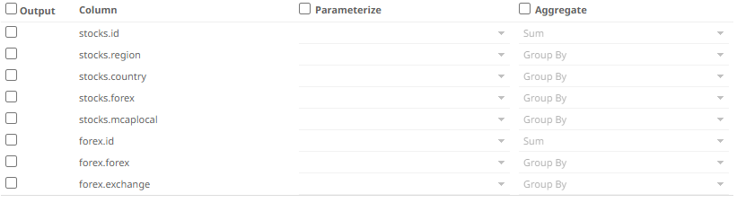

11.   Click . The columns populate the Output Column section.
12.   Individual columns can be added by checking the corresponding Column box in the Output Column listing. To select all of the columns, check the topmost box.
13.   If the data returned is to be aggregated, then the Aggregate box should be checked. For each selected column, the possible aggregation methods are listed including:
·         Text Columns: Last, First, Count, Group By
·         Date Columns: Count, Min, Max, Group By
·         Numeric Columns: Last, First, Sum, Count, Min, Max, Mean, Group By
The SQL query is generated and displayed on the Query text box.
14.   Check the Parameterize box and match the parameter to the appropriate column. By default, they will be matched by name.
The appropriate SQL Query is updated in the Query text box.
